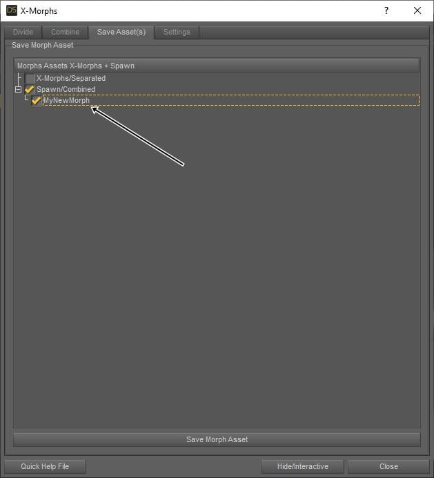

    I have created a Head shape for G8F using X-Morphs, various face and neck morphs and Zbrush morphs I created myself. I want to combine them all in to a single morph and be able to use that as a dial which I can then apply (at whatever % I want) to other G8F figures. I want the new dial to be available whenever a G8F figure is loaded.
    I will NOT redistribute the new morph, so there should be no copyright issues.
    So, could someone talk me through the process?
    PS, The X-morphs script has a Combine Tab, which is supposed to be able to to do this, however, when I select the G8F figure and run the X-morphs script, selecting the Combine tab shows no morphs to combine. When I go ahead and use the spawn morph button anyway, a dial is created at 100% (and zeroing it removed the morphs I have created) but when I close the file and load a new G8F figure that new morph dial is gone.
    With X-Morphs, there is the Save Assets tab, to save morphs(spawn/combination) as assets. For it to work correctly.
    629 x 692 - 55K
