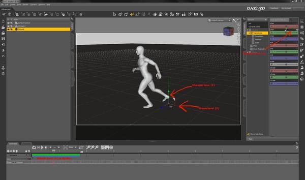

    I love Maya's mesh floor. Maya has some new Improvements
    Maya 2012 and newer versions have a floor magnet that allows you to actually stick the character to a preset level you determine as the floor and the character/obj will follow that level the giving the appearance of the character stuck to the floor during the motion cycle. the best thing with the Magnet is you can use it along the time to raise and low your character over a uneven terrain. this especially helpful for use of cars that require you to make a slide during a animation sequence. and if during a character jumping sequence this make sure your character lands on the floor at the present level rather than dropping below the mesh floor. I'm still learning Maya there are so many tools and tricks
    What I have found to work fairly well for Daz studio to give the appearance that the character is magnetized to the floor is make sure your character/.obj and Floor level are both set at zero in the beginning.. that would be a good starting point so when your moving your .obj along the daz timeline , you will always know your floor level will be zero and you can maintain your character animation to that level by each key-frame that way. to appear as it is stuck to the floor or ground. it can be a lot of work I agree but that is how I found you get the best results.
    I wish there was a script to make a floor magnet , But I'm not very good at scripts so hopefully someone will come up with one. for Daz
    Also helpful . I use the daz spot render tool to test that my character is maintain the floor level before final rendering of a animated scene
    also some ani block that will drop below your mesh floor can be fixed by baking the ani block to the timeline and then correcting the movement and re-baking the fixes to the timeline
    Of coarse I agree it is a little more tricky for moving a obj over a uneven terrain in Daz Studio ;)
    1919 x 1132 - 181K
    Post edited by Ivy on

  • In DAZ Studio, I used a small work-around to fix that sinking issue (tested on a squatting animation):
    - did NOT lock the feet on ground level;
    - Locked transition on Y axis on hip;
    - 2nd frame -  set the squat pose;
                       - move the hip along the Y axis, as much as is needed (did not check yet, but I have a feeling it was needed an increment on Y axis as big as the distance between floor and feet, after posing)
    - exported and preview the animation in the program I needed it for. Worked perfect! No more sinking.
    Hope this will help others, too!
