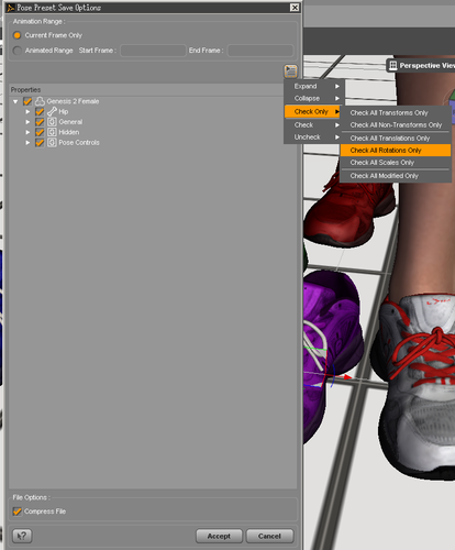

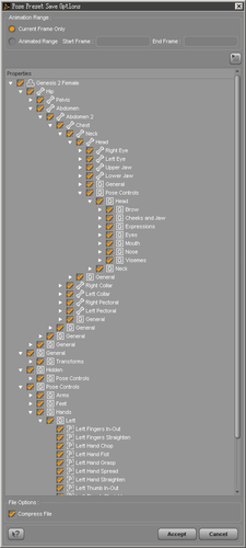

    If the poses are in DS format, you can hold down the Ctrl key (COMMAND on Mac) while double-clicking, and in the dialog box select which nodes to apply the pose to. Save each pose as a new pose preset which only affects the body parts you want, and then you can apply them both without one resetting the other.

    edited August 2014
    Two screen caps to start you out.
    (edit, clicked the wrong button, oops)
    751 x 908 - 171K
    467 x 623 - 50K
    edited August 2014
    And an expansion view of some parts. The pose preset can be made to save, a single thing, or groups of stuff, or everything (including where the figure is in a scene).
    The "unselect all", and the "select only" options in the former post screen-cap can be very helpful for making itemized poses that don't efect other parameters(unchecked ones), like location of the figure or scaling of body parts (you must tell it not to save them).
