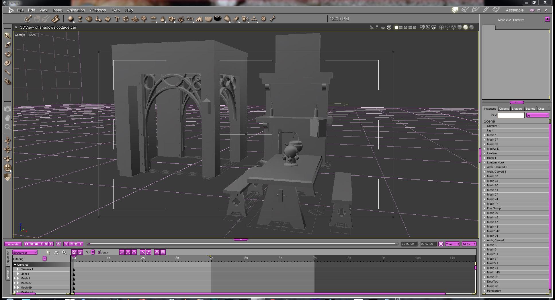

    this is shadows cottage for example
    is a whole bunch of primitives separate import but more or less accurate mesh wise, the walls and rug were way off so deleted those

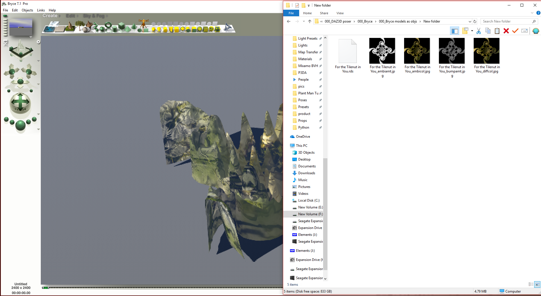

    Hello Wendy, I exported a terrain out of Bryce with jpeg's. Jpeg's were saved in the same spot as the rds file. Normally I export as an obj.
    When I imported the rds file into Carrara I had to load the texture maps from where they had been saved. One thing I did notice was that the textures were a bit off in Carrara.

    For the Terrains it gives you an option for jpeg's when you export, otherwise it's the stock standard bmp which Carrara does not like, I use XnConvert to modify the bmp's.
