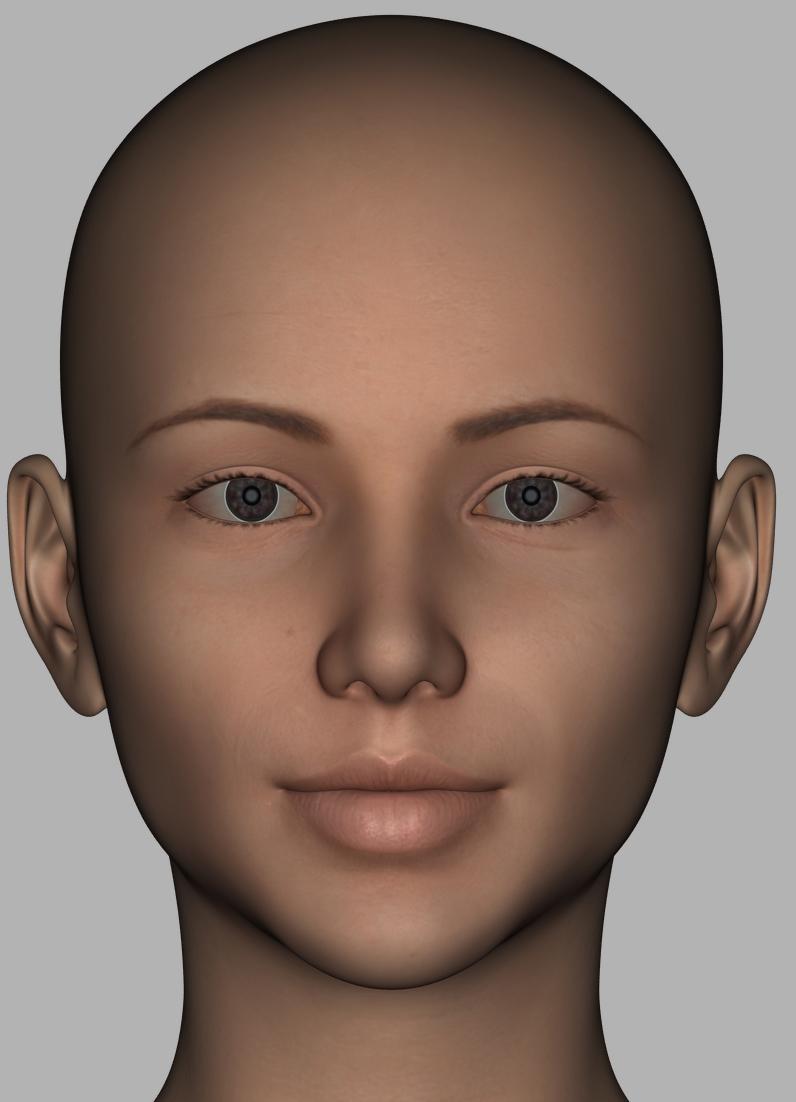

The Chin and Jaw:
RS Jaw and Chin Shape 01 73.1%
Chin Width 83.5%
Chin Pointed -14.9%
RS Chin Depth 59.9%
Chin Cleft 30.2%
Chin Valley Depth 5.3%
Chin Valley Height 13.8%
Jaw Corner Angle -56.7%
Jaw Corner Height 8.2%
Which gives us this:
Hmmm. Not looking too much like her yet. But plenty more adjustments to make!
The Mouth and Lips:
Mouth height -10.1%
Mouth lower to front -18.4%
Mouth upper to front -32.5%
Mouth Corner Up-Down 13.4%
Lips small Y top 9.9%
Lip Depth Lower 24.6%
Lip Depth Upper 50%
Lip Lower Size 92.7%
Lip Top Peak 100%
Lip Upper Curves 96.3%
Lip Lower Center Height 19.4%
Lip Upper Peaks Distance 47.0%
Lips Center Vertical 1 34.0%
Lips Center Vertical 2 -46.3%
RS Lips Upper Tip Creased 35.4%
SY 200 Lip Lower Arch 21.6%
SY 200 Lip Lower Center 54.9%
SY 200 Lip Lower Cleft 20.2%
Which now gives us this:
Better? Well, we got a ways to go yet.
The Cheeks:
Cheeks Depth 23.3%
Cheeks Define 30.6%
Cheeks Lower Depth -9.5%
Cheeks Nasolabial Fold Arc 100%
Cheek Crease 40.8%
Not that much different, yet.
The Nose:
Nose flat 63.4%
Nose height 5.5%
Nose ridge deep 15.7%
Nose ridge round 49.0%
Nose round 143.4%
Nose tip up 82.6%
Nose Bridge Depth -23.9%
Nose Bridge Height 4.7%
Nose Bridge Slope -22.4%
Nose Bridge Width 28.4%
Nose Bump 12.7%
Nose Flesh Size 38.1%
Nose Ridge Width 100%
Nose Septum Depth -29.1%
Nose Septum Height 39.4%
Nose Septum Width -28.5%
Nose Skew -27.6%
Nose Tip Depth -43.3%
Nose Tip Height -32.1%
Nose Tip Width -77.6%
Nose Width -29.1%
Nose Curve In 19.8%
Nose Style Angular A 100%
Nose Depth -11.2%
Nose Wing Height -100%
RS Nose Septum Curve In -2.3%
RS NoseTip Rounded 45.1%
Nostrils flat 79.9%
Nostrils turn up -120.6%
Nostrils wide 37.1%
Nostril Wing Height -26.9%
Nostril Wing Width -20.9%
Nostrils Front Height 25.4%
Whew, which now gives us:
Starting to look like ... someone?
The Eyes: (The windows to the back of your head, if you are a 3D figure)
Eyes big 45.4%
Eyes depth 35.5%
Eyes height 8.7%
Eyes height with eyebrow 1.5%
Eyes slanted to inner 30.4%
Eyelids Lower Up-Down -3.8%
Eyes Squint-Widen -25.6%
Eyes Iris Size 11.9%
Eye-Left Vertical Up Down -3.0%
And so, we now have:
Now we seem to be getting ... somewhere.
The Brow and Eyebrows:
Eyebrows inner up 1.5%
Eyebrows up -33.2%
Brow Depth 59.1%
Brows Distance -66.4%
Brows Middle Height -30.6%
Brows Outer Height 34.3%
RS Brows Angles 45.1%
Brow Up-Down 5.1%
and finally,
Overall Face:
Face wide 24.0%
Face Angle -14.8%
Face Lower Depth 32.9%

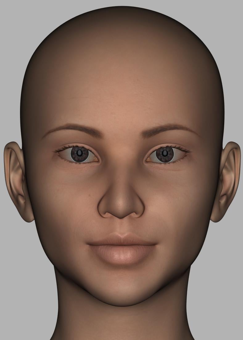

Which gives us:
Now, I know what you're thinking. No, seriously, I know what you're thinking! But never mind that, back to our character. It doesn't really look all that much like our reference, you say. Well no, but thats because, after having her face pushed and poked, pulled and prodded, shes looking a little peaked. Thus far we have been focusing on the mesh - it is the shape that we have been interested in recreating. Obviously to complete the illusion (or not) we're going to need to apply an appropriate texture/material to that mesh to really see how well we've done. Some fine tuning of the eyebrows will need to be done once we have chosen and applied a texture.

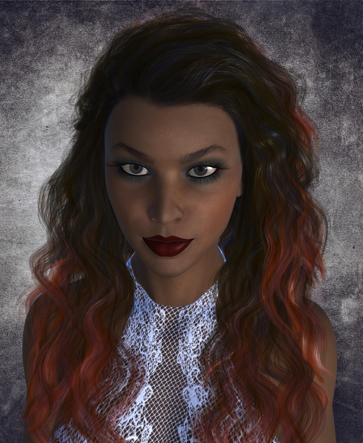

You have been very patient. Those of you who have managed to hang in here, anyway. So, I applied a texture to our morphed character and tweaked it a bit, then added a hair, some clothes for modesty, some proper lights and then rendered the results. So here, for your consideration is the more-or-less finished result of our labours. Now this is not your Iraymyrayallthewayhooray render. No, this is, in the words of Ned Flanders, a "3dDeedelylight" render. So not photoreal, whatever that actually means. Not a perfect success, perhaps, but an interesting enough character to add to the content library nontheless, no? Anyway, that is probably how I'll leave it. All she needs is a name - Andrea, I'm considering.
