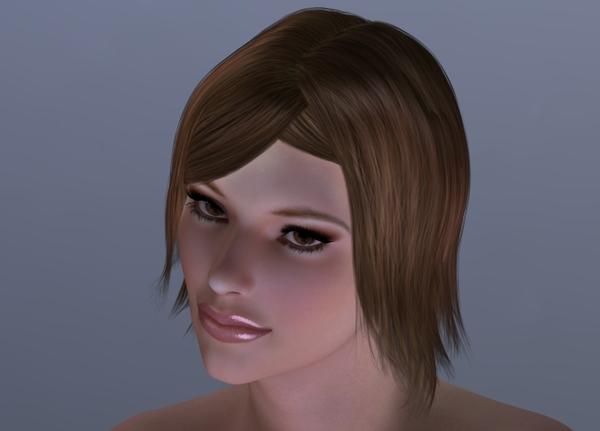

    I just added the External Daz Library to the runtimes tab at poser... And voilá! I can't believe I forgot that, I'm feeling so... dumb!
    A sweet smile from V5 as a example:
