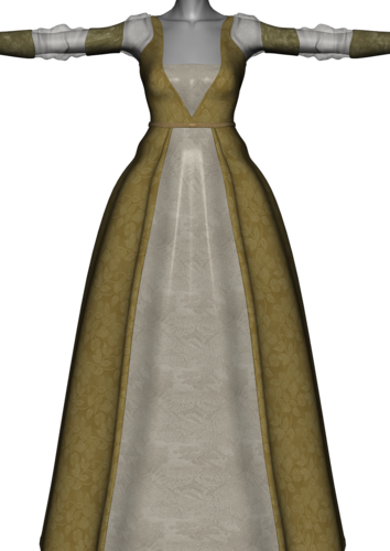

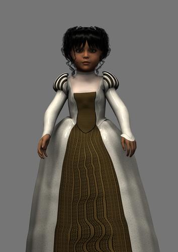

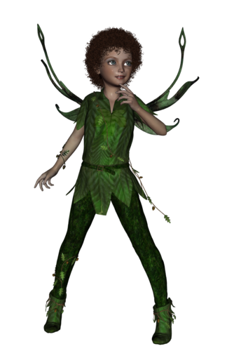

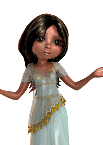

    Some examples of autofitting old clothes...steph3 toga, puck outfit for m4 and a3's renaissance
    You can see the distortion I was talking about on the renaissance skirt on the child...here is one with the skirt fixed on a3's forever after.
