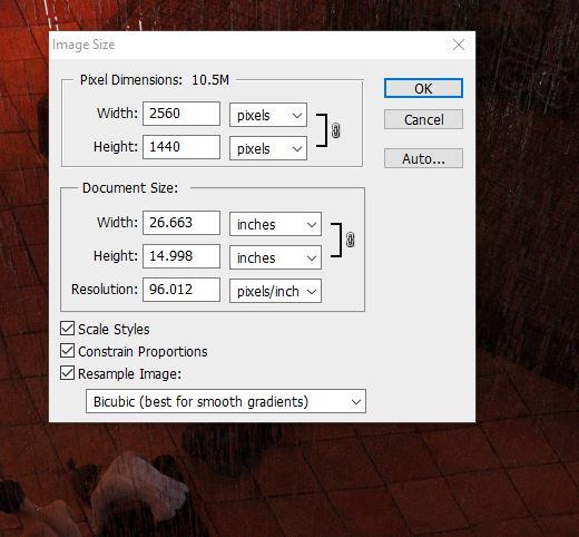

    DS does not assign a PPI value to the renders.
    Do you mean DPI, instead? Because Daz is consistently landing at this 96.012  PPI setting.
    I still don't know why that 150 resolution is sticking in my mind.
    520 x 482 - 51K
    Post edited by Griffin Avid on

    If you set the size in inches (or cm, or points - any physical unit) then of course PPI matters - without it you are not telling the application how many pixels to use. But if you set the size in pixels then PPI has no bearing on image quality per se, just on how big the pixels (and so the image) are.
    I meant PPI - pixels per inch. DPI - dots per inch - is a measure of printer capability, and will be higher than the optimal PPI for the device (since printer dots have fewer possible colour values than pixels it takes multiple dots to match a pixel).
    When you load an untagged image Photoshop (or whatever you use to edit) will assign a value - but that isn't in the file, and in some cases you can choose what value is assigned (72 and 96 PPI are the common choices).
