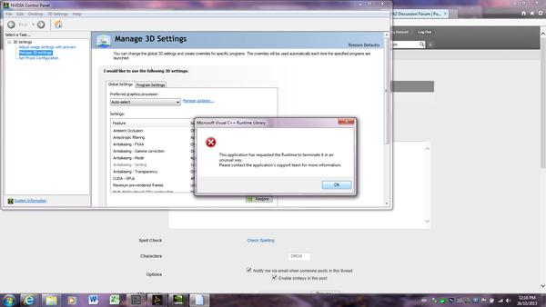

    I tried to update my NVidia driver and I get this error message
    1600 x 900 - 521K
  • fixmypcmikefixmypcmike Posts: 19,719
    Hmm, never tried to update my driver using the NVIDIA Control Panel. I get the same error whether nvinit.dll is disabled or not.
    You guys might have issues with your cards. I've been running dual Nvidia GPUs in SLI for the last couple years and I've never had issues with games, dim, or cms.
    Also, you don't actually update through Nvidia's app, it just searches for new drivers and then you click a link to download them. It's just a glorified search without having to hunt for it yourself on their website.
    Judging by that error window though, it could be an issue with your MS Visual C++ libraries and not the Nvidia panel.

  • KharmaKharma Posts: 3,214
    Vaskania, any idea how I fix that error or find out what's causing it?
