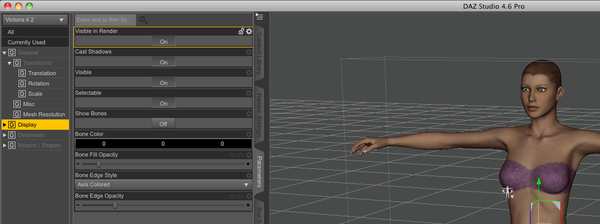

  • FauvistFauvist Posts: 2,290
    edited October 2013
    It's exactly this type of intensely frustrating problem that has made me resist using DAZ Studio for years. It's so incredibly stupid. There's a figure in the viewport and it is invisible in the render. Genesis, with a texture, is standing in the middle of this scene. I've spent 5 hours tyring to get this character to render. I loaded a 2nd Genesis into the scene and applied a character and rendered it again. This 2nd Character shows up in the render, but the first character is still invisible.

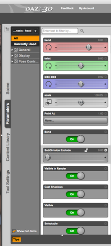

  • StratDragonStratDragon Posts: 3,289
    Does it render w/o that background?
    Is "Visible in Render" on or off in the properties?
    1166 x 435 - 118K
    edited October 2013
    Visible In Render is "on". It doesn't render with the background, or without the bakgreound, or with different lighting. I just applied exactly the same texture to the first character as I did to the 2nd character who shows up in the render. So it doesn't have anything to do with the texture, or the lighting.
    Post edited by Fauvist on

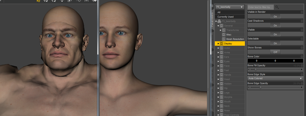

    I edited my post. I actually couldn't reproduce it. I just didn't realize the CR2 loaded automatically with Visible in Render set to OFF.
    1044 x 408 - 148K

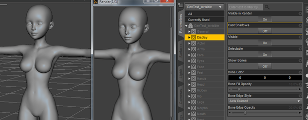

    edited October 2013
    Ok, there is something definitely wonky somewhere. Here's what I did:
    Loaded Genesis in PP2014
    Turned off SubD
    Manually dialed in F5 and a GenX-ed M4 Beer Belly
    Applied F5 textures via PoserCF
    Turned SubD back to 1
    Saved to library as a CR2.
    The character loads fine in DS, the textures render well, yet the render looks like a base Genesis and not F5.
    /edit
    Upon closer inspection... see closeup. o_O
    You might have rogue mesh loading with your CR2 that's overriding your visibility settings (just as mine is overriding the F5 morph)
    I have this same issue using the Bot Genesis PoserCFs in Poser. No idea what causes it or how to fix it.
    648 x 618 - 378K
    1376 x 520 - 383K
    Post edited by Lissa_xyz on

    I remember, about 6 hours ago, there was a 2nd mesh, like the one in your example. I just deleated it. Do you think it does something to the render settings?
    edited October 2013
    I'm not sure. I can visibly see the 2nd mesh in the DS viewport, but there is no 2nd mesh in the scene/hierarchy tabs.
    I wonder if the 2nd mesh I'm seeing is the SubD "shell" from Poser.
    /edit
    Yes, the 2nd mesh from mine was the subD shell from Poser. I re-saved the CR2 with subD off and no longer have the problem. The UVs for the textures didn't save right for some reason, so the maps are all misaligned, but that's an easy fix using the DS mats.

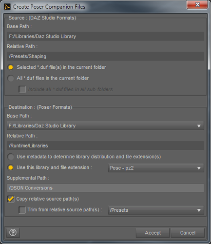

    edited October 2013
    Genesis is Triax by default, the problem is you're using the PoserCF version of it, which is Poser weightmapped. Honestly, you're going backwards. Here's what you should do.
    Create your Genesis character in DS.
    Save out the shaping preset by going to file > save as > shaping preset (best option is your Genesis Library > Presets > Shaping > Optional Subfolder)
    If at this time you want to use your figure in Poser's cloth room, find your shaping preset in the content library and single click on it to highlight it.
    Now you'll need to create PoserCFs for your preset.
    Right click on the Content Library tab (with your preset still selected) and choose Create Poser Companion Files.
    Here's a shot of the settings (obviously your library name will vary). Set these and hit accept. To find them in Poser, open your Genesis Library and go to the Poses tab and look for DSON Conversions > Presets > Shaping.
    Load Genesis in Poser and use the preset you just exported out on it.
    466 x 538 - 46K
