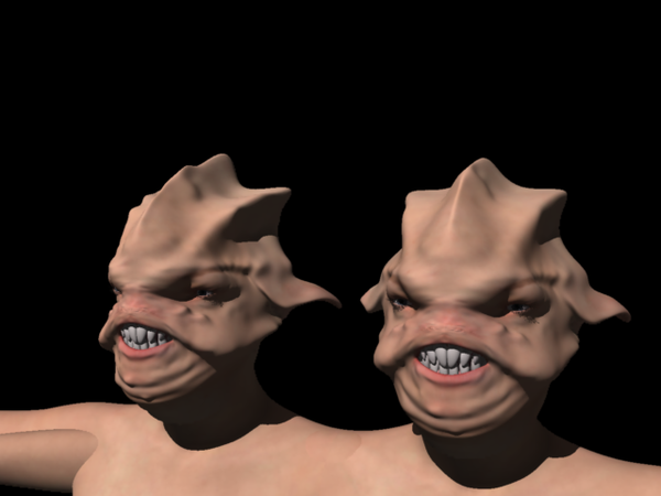

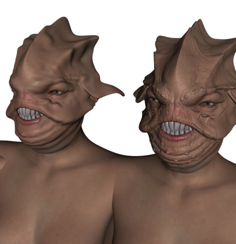

  • ncampncamp Posts: 345
    Here is a studio and Carrara example. Note, I'm not saying there is not a way to make them work, but I don't know how to yet.
    On the left is Normal CC for GF2 and the right is CC HD, First render is Studio, Second is Carrara. As you can see the HD is lost. (By the way, I exported the studio scene and imported into Carrara. I got the same results using natively.
    ncamp

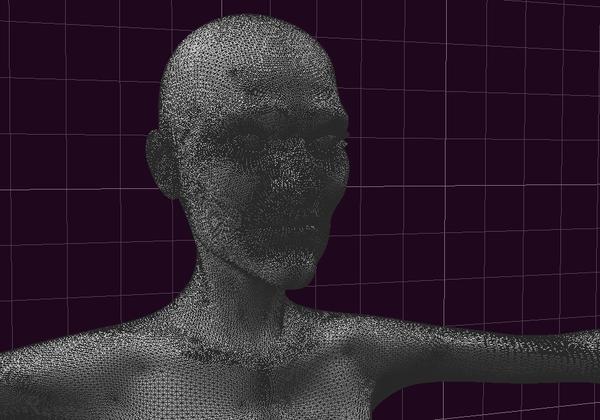

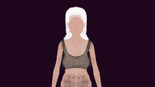

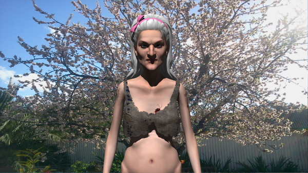

  • WendyLuvsCatzWendyLuvsCatz Posts: 41,835
    edited October 2013
    wireframe render and the hair room tells a story
    Awesome example! What was smoothing set at for this?
    that was a .duf import
    I cannot get G2 F to work properly loaded from Carrara I am afraid, need to fit clothes and do morphs in DS4.6
    can animate and use mimic in carrara

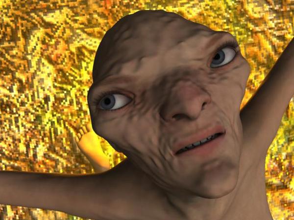

  • thoromyrthoromyr Posts: 452
    The smoothing levels in Carrara definitely have some effect. Here are some test renders. At 5 the memory usage went up to 5GB and it is *slow* rendering even these small images without particular quality. The first is w/o the HD dials, then it is smoothing of 3 and 4
    this is a mixed-morph setting render so it isn't as clear as it could be I suppose. This one is only at three levels of smoothing and is identical to the others except I raised the various HD Detail morph settings from 1 to 2. Right or wrong, the HD morphs definitely have effect...
