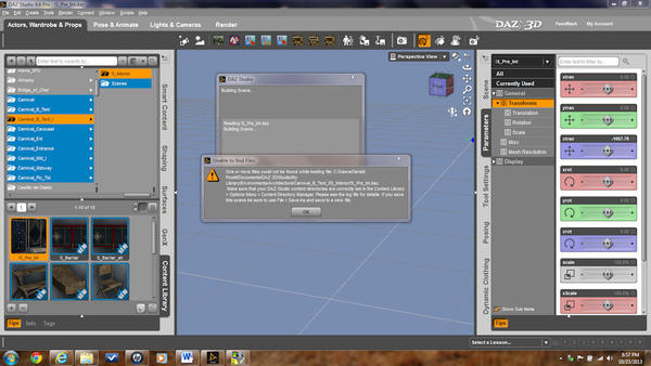

Am I missing a file.
I have both Carnival Big Tent and Carnival Big Tent Interior, but I keep getting a missing file error. Daz install manager installed everything, and during the time of the carnival sale.

    When you try to load the file, it will give the relative paths of the missing files in the error log (in DS Help > Troublehooting > View Log File).
    Odds are the required file has been updated, so you have the .duf versions rather than the legacy files. If that's so, post in the thread about the Carnival .99 sale to let JGreenlees know the textures need to be updated, in case it isn't already one she's working on.
    If you're in a hurry, there are two things you could do in the meantime to get it working:
    1) if there are materials presets in addition to the preload, you could load the ,duf (or the Poser version) and apply the material presets to it. It could be a lot of items, however.
    2) you can download the legacy version of the required file and install that.

    A lot of the texture sets for the Carnival pieces do not seem to work correctly In DS. The scenes that are suppose to load the piece with the alternate textures are looking for the geometry files in the wrong place.
    When I load the magic big tent interior, I get these error in the log file (only a few of the errors):
    Merging file !S_Pre_Int.daz...
    Unable to find file for storable: data/cbti_entrance_11876/bti_ent/cbti_entrance_11876_bti_ent/geometry.dso
    Unable to find file for storable: data/cbti_entrance_11876/bti_ent_cur_s1/cbti_entrance_11876_bti_ent_cur_s1/geometry.dso
    Unable to find file for storable: data/cbti_box_1760/box_s1/cbti_box_1760_box_s1/geometry.dso
    Unable to find file for storable: data/cbti_box_1760/box_s2/cbti_box_1760_box_s2/geometry.dso
    If I use DIM to look at the installed files for the tent interior, I see (again just a few of the entries):
    /data/Jack Tomalin/CBTentInt/CBTI_Box/cbti_box_1760.dsf
    /data/Jack Tomalin/CBTentInt/CBTI_Entrance/cbti_entrance_11876.dsf
    The main Big Tent and interior sets load fine, but the texture sets do not. It looks like the geometry files have been moved and these texture sets have not been updated.
    It's a problem that's been hitting a few of the not-so-new sets (e.g. Curious, West Park) that are being updated from Poser stuff plus D|S textures to the new Poser/DSON/Legacy triple format. Apparently some of the Legacy files are assuming the object files will be in a /data/3_0/ folder when they aren't, or vice versa. (I kept using D|S1.8 for a long time, so a bunch of my /data/ files aren't in a /data/3_0/ folder.) A similar glitch seems to affect recent texture sets, if you haven't updated the original scene set (in this case you won't have the /data/PA-name/ folder the new texture .duf scenes are looking for). I've found one way to work around it is to update all the items in that set, especially the original; that way everything matches and all the /data/ files are put into the proper folders. Only problem is, this won't help if as someone mentioned upthread the original set hasn't been updated yet.

    Questions time.. What are you using? If you are using a texture add on pack for any of the carnival sets you will need to use the legacy version of the carnival sets. I haven't yet made it to gettting them updated.
    The legacy files have the 3_0 data files and the version before that (Which wrote the data fles in the root data folder.)
    The carnival sets are a priority with me and I am working on them as I can. I promise I will get them done but please try installing the legacy version and then see if the texture set works.
    If you are manually installing and only want the data files so the add-on will work you could just extract the data files and that wouldn't give you the user facing legacy files but would give you the data so you could open the preloads to the textures

    From the screenshot you can see that the problem is occurring with the legacy files. I don't know why someone using DS 4.6 is installing the legacy files, but I can assure you that the DSON files for Big Tent and Big Tent Interior are working fine. The problem also occurs with Carnivale Entrance, which does not have a DSON version. If you try load any prop or scene from the StudioCF package installer (which is basically in the legacy format) you will get the same error that shows up in the screenshot above.
    There are an issue anyway with the DSON package installer. They don't carry the materials presets, so if you are mixing textures with other packages you cannot get back to the default materials using a preset. It is workable, but a little inconvenient.
