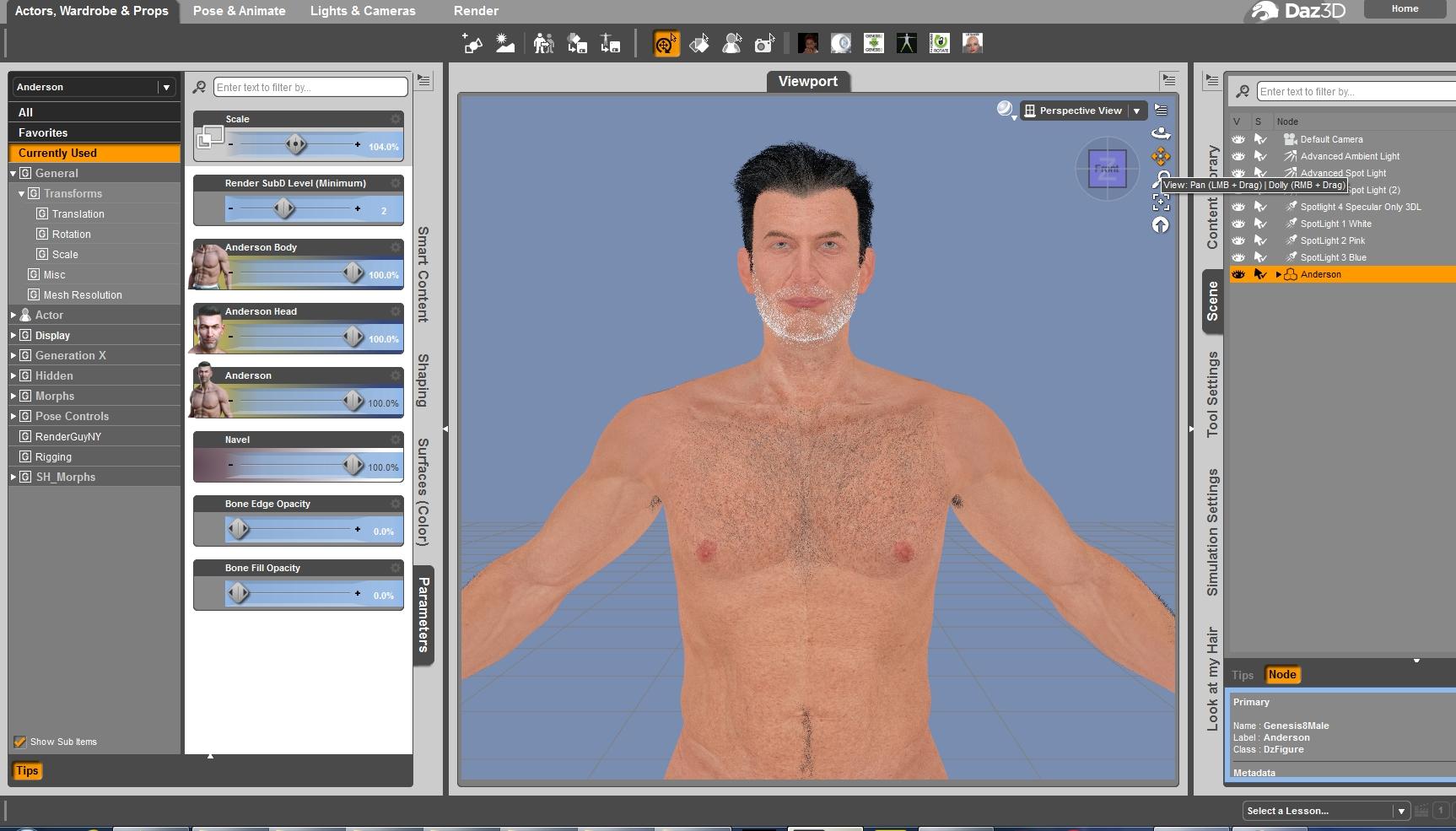

    I've uploaded two images "Anderson" & "No Anderson". As you can see from the slider, that is the difference that I get!
    I have already uninstalled & re-installed the file.
    1919 x 1039 - 592K
    1904 x 1036 - 509K

    I took another look at your images again, and I can tell part what's wrong with your Anderson installation, although I don't know why it's happening.
    In your parameters tab, you have a single Anderson slider -- his main full body control slider. However, there should be three sliders with the word "Anderson" for him -- control, head, body (see attached image). He's not working because he's not all there. It looks like he's got his scaling, and a bit of his body shape, in the control slider, but nothing else.
    Anderson screen cap
    If you can, look at this folder: data\DAZ 3D\Genesis 8\Male\Morphs\Faber Inc\Anderson
    The part before "data" will be wherever you have your content installed, so the fuller path may be something like
    My Daz3D Library\data\DAZ 3D\Genesis 8\Male\Morphs\Faber Inc\Anderson or some such
    In that folder, there should be 34 files: 2 .dhdm files (encrypted, his HD files); 3 PNG images (the images for his sliders), and 29 other .dsf files, with his visible sliders (file names start with FBM, FHM and CTRL) and his PCMs, JCMs and other stuff. At the very least, I would think your directory as it now stands is missing his FBM and FHM file, since you can't see them. Alternately, the files are corrupted so that Studio can't see them.
    The only thing I can suggest is doing a manual download and install, since you've done a DIM install and it didn't work. In theory, they should be the same ZIP file, but maybe DIM isn't handling something correctly.
    Before doing another download/install, I would trash that directory, so that you know you're doing a clean install.
    I'd imagine that the same thing is happening with your other troubled products -- they're literally not all there -- but unfortunately, I don't have them to check.
    1726 x 985 - 587K
