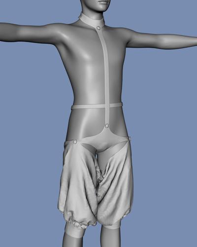

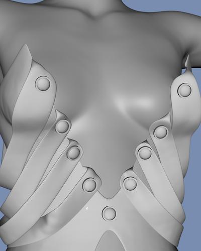

I cannot get the hang of rigidity maps.
I set the entire button as the participant.
I set the polygons under the button as the reference
Fill the weight map 100%
Morph or post the character and the button deforms.
In fact the rigidity maps seem to just make things worse because now buttons sink into the figure.
How do I make it stay round and stay on top of its reference polygons?
[EDIT] Okay I figured out how to keep the shape. Have to disable the secondary and tertiary scale maps. But how do I keep it on top of the reference polygons so the buttons don't sink into the figure?
1000 x 1250 - 363K
Post edited by ghastlycomic on

  • Richard HaseltineRichard Haseltine Posts: 111,992
    You don't have pre-existing generated morphs on the item, or you are clearing them? Rigidity mapping helps only with newly generated morphs. Also, are you giving each button a separate rigidity group? If you don't it will average the behaviour, I think - it certainly won't do what you want.
  • ghastlycomicghastlycomic Posts: 2,531
    I'm creating the rigidity map after using the transfer utility to fit the item to Genesis. I haven't created any morphs other than the ones the transfer utility creates.
    Each button is it's one rigidity group. I've tried making the reference groups for the buttons bigger and it's worked for some buttons but made other buttons worse.
    I guess if I just keep tweaking the ratio of reference to participants I'll eventually get something that works.
    Essentially, as I understand it, whatever happens to the reference polygon happens to all the polygons in the rigidity group. You can use Edit>Figure>Clear Generated Morphs to clear out the morphs so that you know you have a clean version to test.

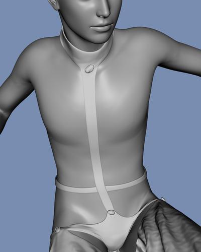

    SUCCESS!!!
    I guess rigidity maps is yet another one of those save and tweak functions. %-P
    1000 x 1250 - 371K

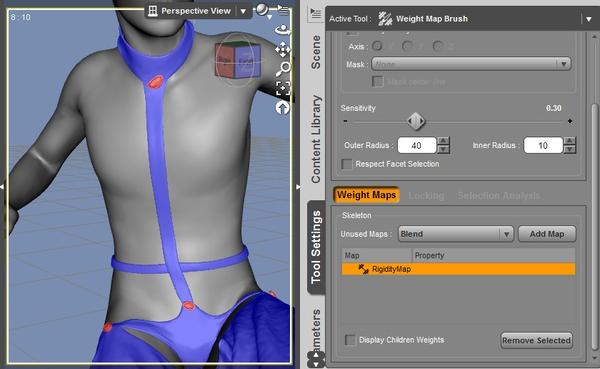

    I seriously don't understand rigidity maps. They seem completely random in function. I did everything exactly the same way only this time nothing has changed, nothing is rigid in the least. The maps might as well not even be there.
    It took me 5 tries just to fill the selected polygons with the rigidity map. You know how the map is supposed to be blue when it's zero and then red when it's full. Well for some reason the map was just grey and it wouldn't let me fill the selected faces. Then after the 5th attempt it was finally showing up blue and let me fill.
    1000 x 1250 - 275K

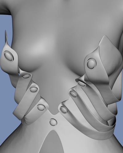

    Okay... it looks like the rigidity maps are actually working the same for the corset as they are for the pants. I guess rigidity maps only work with morphs but still deform when the mesh moves. I didn't notice it on the corset because it really only deforms very slightly when the figure moves and only in certain areas where as the pants its much more obvious.
    Is there simply no way to have true rigidity on a piece of conforming clothing? If you need something truly rigid do you have to create it as a prop and then parent it to the clothing? This is unbelievably frustrating that something that should be a simple one button click is so ridiculously complicated to implement.
    Just give me the damn "DON'T CHANGE SHAPE EVER" button for crying out loud!
    1000 x 1250 - 315K

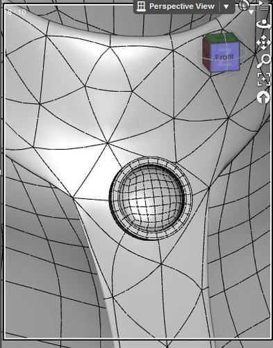

    Can you post a wireframe image of a button?
    The mesh underneath where the buttons go has to have lots of mesh there to "support" the buttons.
    Also the buttons have to have a lot of mesh to help hold their shape too.
    The buttons are 500 polys each. How many more do I need?
    Ha! I was close. 456 polys. The mesh underneath doesn't have that many but there's not much I can do about that because it's a mesh I made with Marvelous Designer so I'm stuck with that.
    406 x 516 - 55K
    Providing the back of the button is as detailed mesh-wise as the front, yes that should work AFAIK.

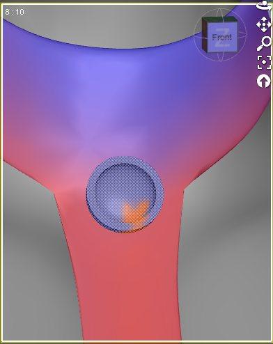

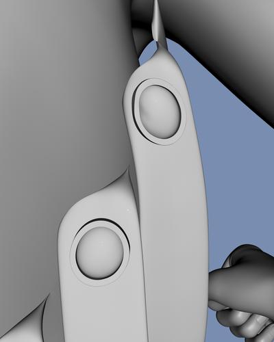

    I've noticed a new problem.
    When changing the weight setting of the buttons I noticed on one of the buttons the Z rotation had a hot spot on it. So I tried filling the polys with a zero % and the hot spot remains unchanged. Is this a bug?
    392 x 494 - 22K
    edited October 2013
    WOOT!!!! It's working! It requires a lot of experimentation to get the weights just right but it's working! Two buttons down 4 more to go.
    Wow. Who would have ever guessed making buttons on an outfit would be so much work. This is definitely going to change the way I design outfits. VELCRO FOR EVERYONE!
    Thank you thank you thank you Richard and everyone else who helped!
    Off hand I'm not sure there is a way to sample a weight from one vertex to apply it to another, sorry. I'm also not sure what's happening with the hot spot.
