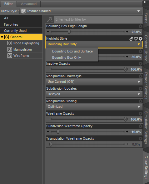

    Can you show all of your Draw Settings for Texture Shaded? It looks like some others have been tweaked. This is what mine looks like right now...
    The other option is to turn off the ability to select the object in the viewport.
    On the scene tab, click the arrow in the 2nd column next to the things you don't want to be able to select in the viewport. In the screenshot below, if I hover over the Ceiling, Floor, or Rug objects, it will not be highlighted in the scene.

  • What set is this? If it isn't the selection yellow, it could be a specific shader. I don't remember what causes viewport weirdness with special shaders, but having them take on a bright color is something I have seen, though not as strongly as you showed here. If it is a shader thing, does it go away if you switch to the Nvidia viewport mode?

  • dash2128dash2128 Posts: 736
    I selected the Nvidia viewport.
    That did seem to change things.  I haven't checked to see if this mode is practical for me to use, yet, however.
    ...but I will.
    Thank you!
