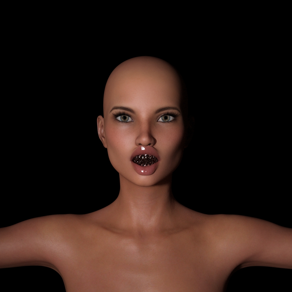

Image 1: Spotligt aims to face, Render: Dome and Scene settings. Teeth surface settings: Reflection weight - 1.0

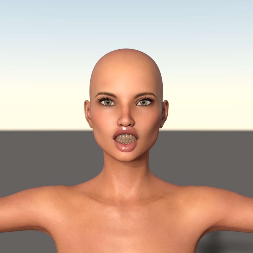

Image 2: Spotligt is aimed at the face, Render: Scene only settings. Teeth Surface Settings: Reflection weight 1.0
(this is the problem).

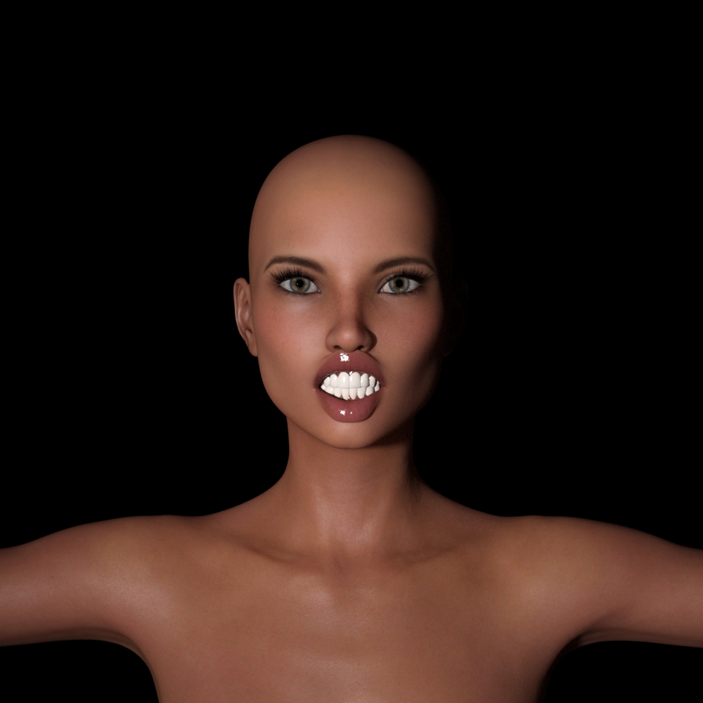

Image 3. Spotligt is aimed at the face, Render: Scene only settings. Teeth surface settings: Reflection weight 0.73

The problem of rendering teeth is the setting of the parameter Reflection weight, which in some models is set to 1.0 by default.
