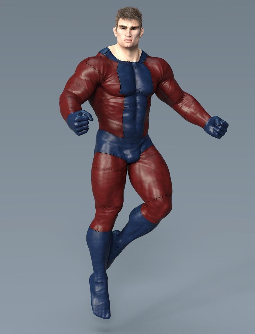

    I tried the method of having a figure to copy from and it greatly streamlined everything...
    1. I loaded the no suit figure and zeroed out the morphs and removed geographs where I wanted exposed skin.
    2. I added the default materials to figure and geographs.
    3. I applied appropriate shaders to areas I wanted and copied over textures from donor figure.
    4. I added morphs, hair such as head hair, eyelashes, and eyebrows and shaded them.
    5. I deleted donor figure, posed no suit, and lit the scene.
    6. I rendered the scene.
    7. Here is the results.
    877 x 1148 - 100K

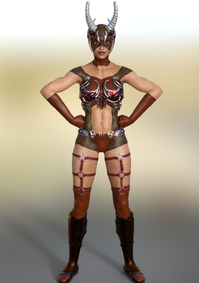

    Wow!  That's pretty cool!  In the end I somewhat followed the same order you did using a 'donor' figure.   Here is how my superhero turned out:
    As you can see, with all the exposed areas on her suit, it was very tedious.  However, in the end I was very pleased with the results.
    Cute isn't she?  The only thing is that I haven't given her a name yet, nor figured out what super power she has. But whaever she ends up doing, she will look damn good doing it!
    Thanks for the help!
    647 x 916 - 505K
