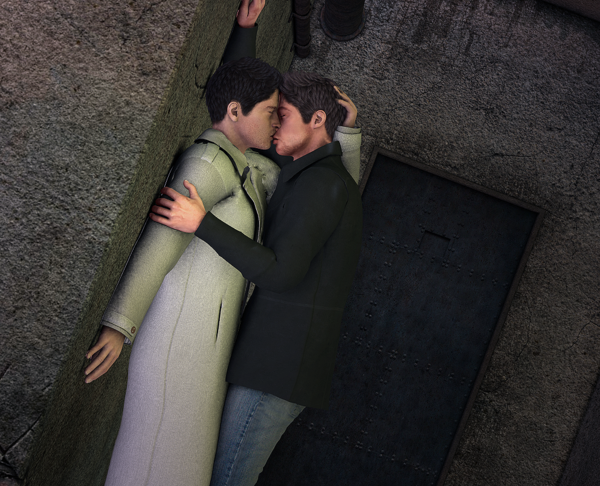

Can somene tell me why this happens?
UpiriumUpirium Posts: 728
The glow I get when something is close to something? You can see it behind his arm. It's made a little worse by the sharpening I did on the pic...
Idk why it does this?
Using Poser Pro 2012.
993 x 804 - 2M
  • Richard HaseltineRichard Haseltine Posts: 111,350
    If you are using a shader with sub-surface scattering make sure the different figures have a different group ID - surfaces that share a group ID will, if close enough, scatter light to each other even if they are parts of separate meshes.
  • KeryaKerya Posts: 10,943
    Are you using IDL?
    IDL and SSS together are giving the glow effect.
    Select your character body and un-check "light emitter" in the properties panel.
  • adamr001adamr001 Posts: 1,322
    Looks like Anti-Aliasing to me
  • barbultbarbult Posts: 27,497
    Are you talking about that light line between the arm and the wall? Try lowering the shadow bias on your lights. Try setting it to 0.1 or less, and see if that helps it.
