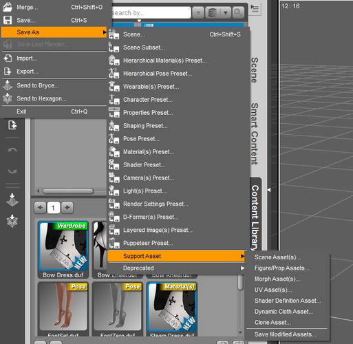

    Also is there a list of what all the different save presets do.. I have tried different ones and don't seem to save the right way. for Example I was saving a character and the skin saved but the facial expression was gone. Attaching which menu I am wondering about
    650 x 633 - 288K

    Answered my own question, checked an item I had converted with SRMS and yes saved to the data/author folder in my library.
