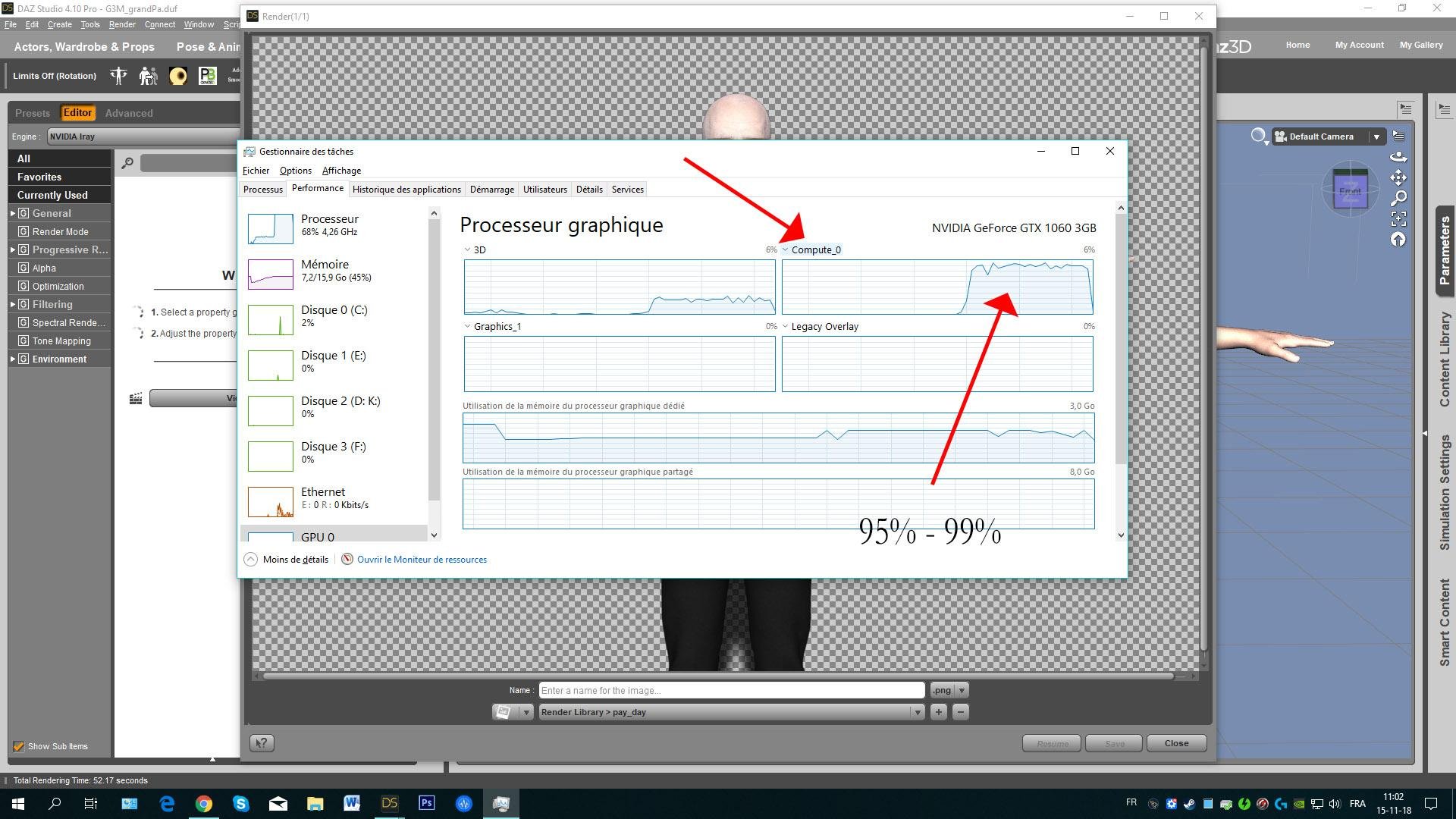

    in my case, on task manager, right side window of GPU, in "copy" nothing show
    while i render in Iray, I use "compute_0" to see result, it report 93% to 99% use
    previous port pic,,
    https://www.daz3d.com/forums/uploads/FileUpload/22/f0ed2d2b72cb2748eca0c713e55876.jpg
    note:
    also the GPU memory not show correctly in task manager resources when your scene use more than 1.8 GB video memory
    Post edited by cm152335 on
    previous port pic,,
    note:
    I'm not sure what that means, but for me I no longer fall back to CPU renders.
    I'll roll back the driver and compare renders times to see if that makes a difference.
    -- UPDATE:
    I rolled back to 417.71, re-rendered the scene and had almost the exact same rendering times; 36.5 vs 36 minutes. No CPU, both 1080 & 1060 GPU's as well as OptiX enabled.
    I'm upgrading back to 419.35.
    For what it's worth.
