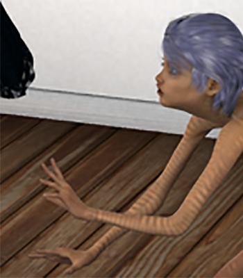

Hello everybody.
I have a weird problem which is random apparently.
I mean to me it's because of lights, but i can't figure what is the problem or how to fix
Below there is an image of Josie i cutted from the scene, i was working on a story so the body is heavy morphed.
Why i got this stripes all over her body ?
If i render her with uber enviroment it works great, what is wierd is that i used also a very low dististant light and sometime works sometimedon't.
Same problem with Victoria 6 and Gia in some scenes them skin has this stripes.
Render setting are fine i use shading Rate value of 0.1 because, some of you suggested it, with genesis figures, i solved a problem, of all characters skin texiture wite line on the legs.
Thanks so mcuh for help
Kind Regards
Jack

  • TotteTotte Posts: 15,114
    This has to do with SSS (Sub Surface Scattering) on the skins, but I've forgot what the cure was, but know when you know you might search for it in the forums.
  • edited December 1969
    Dear Totte
    I keep SSS to standard value, and on preset i changed it to see if i could solve the issues, no way to get rid of this stripes.
    I had this problem when Victoria 6 was released, unfortunatly i searched everywhere, but didn't find a solotion, this is why i decided to open this post.
    Anyway if we find out that SSS it's the problem i badly hope that someone can help me giving me the solution.
    Kind Reagrds
    Jack
  • Richard HaseltineRichard Haseltine Posts: 111,382
    Try adjusting the SubSurface Scale and/or shading rate on all surfaces with the same subsurface group value. And make sure that surfaces with the same group value do have the same scale and shading rate

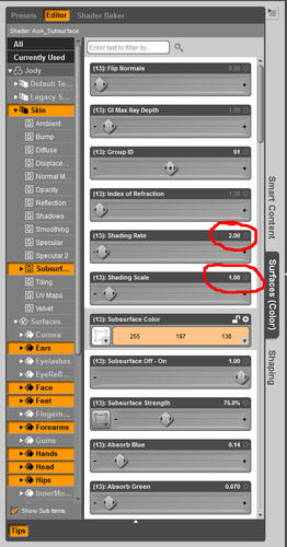

    EDIT :
    Partially Sovled ( works only with scene i was doing )
    Decreasing "Shading rate" from 6 to 2 and increasing "Shading scale" from 0.5 to 1
    I made some tests and if you increase, "Shading rate" the stripes are even more visible.
    Thanks so much !

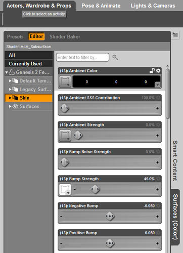

    Each figure should have a different number in group ID.
    If you are not seeing Subsurface scale for Josie, does it say Shader: AoA_Subsurface at the top of the Surfaces pane for her as it does for Jody in your screen shot?
  • edited October 2013
    Dear Richard
    Yes i attached you the screen...
    The Group ID it's 64 while i noticed for other figures that is set to zero, but others figures like Norma, has different parameters, compared to to Josie
    I never had any issues on skin texture, so i don't have practice , this looks like advanced things, that i'm trying to learn, but i far from understanding these parameters sorry.
    Jody is name i gave to character real name was Genesis 2 female
    Kind Regards
    Jack
    516 x 712 - 113K
    Post edited by giacomo.civardi_f43255c5a6 on
    The screenshot shows Subsurface scale, but in your post you say "Wy i have sub surface scale on other skins figure and not on Josie ??".

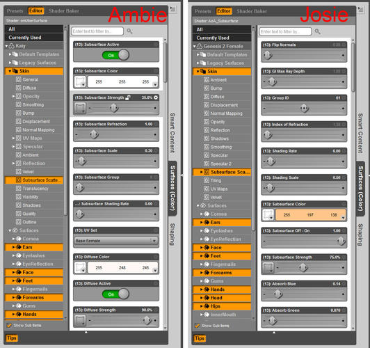

    Dear Richard
    That's a comparison on the left Ambi material working great with every lights, on the right Josie
    Parameters are totally different and on Josie i don't see anywhere "Subsurface Scale"
    Kind Regars
    Jack
    1059 x 996 - 375K
    Sorry, Shading Scale is what I meant. Ambie is using a different shader - uberSurface - so it isn't behaving in the same way, and doesn't have the same settings.
    Dear Richard
    No problem ;) so back to us Jodie texture.
    I made some tests the value of "Shading Scale" works only increasing it, and not alone, i put it to 2 and still had issue so i lowerd to 1 "Shading Rate" and finally the problem was gone.
    Now to the big question ,i had to do all time this, when i found i had issues , aslo, with Victoria 6 and Gia, there is no way to predict if standard value will work ? just render wait and see ?
    Sound quite wierd, also we are in a begginer section of forum i can understand people who like to tweak things.
    But gosh i spent a lot of money to find out that half of skins textures don't work well.
    Never had porblem with genesis and even don't what to be a pro, just have fun without going insane, to discover what is the problem, i'm still learning lights, there are so many things to keep in mind, but asking that default things has to work well, after paying them, i don't think is too much.
    Thanks so very much for your incredible patience and help.
