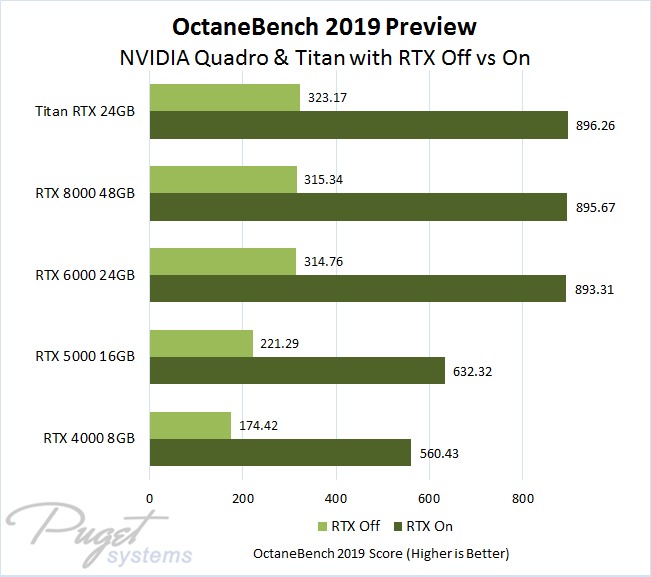

  • RobinsonRobinson Posts: 751
    Some new benches.  Octanebench shows up nearly 3x faster with RT enabled.

  • LenioTGLenioTG Posts: 2,118
    Wow!!! :O
    I can't wait to get a RTX card and for Ray Tracing to be implemented in Daz! :D
