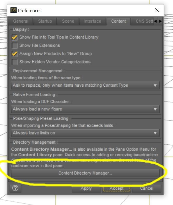

    Start by opening Daz Install Manager (DIM), then click on the gear-wheel icon at the top right, then the 'Installation' tab. Look at image 1 as to what to select, to find how to change where things get installed.
    Once that's done, you can open Studio, and press 'F2' on your keyboard, or select 'Edit', then 'Preferences' from the Studio menues. Select the 'Content' tab, then look towards the bottom of the new pane for 'Content Directory Manager'. From there, it all depends on how your directories are set up, as to what paths you choose.
    1028 x 1104 - 318K
    664 x 788 - 185K

    Are you trying to install the programs (DIM and DAZ Studio) to the D: drive also, or just the content?
    DIM's default installation is the "Recommended DAZ Studio/Poser Content Folder", which is on the C: drive, but you can change that to something else in the Settings dialog. You can also change the default Package Archive folder, the Thumbnail folder and the Manifest Archive folder. It is not related to where DIM is installed.
    DAZ Studio must be configured to look in the same place for content to which DIM installed it. It also has the same default Library folder as DIM (on the C: drive). You can use the script that Richard pointed out, or set it up manually. This is done in the Content Directory Manager. Set the same path as you did in DIM for DAZ Studio format and Poser format content. If they line up, your Content Library will be populated.
  • DIM and DS will, on a clean install, default to placing installed content on the C: drive in the Public Documents folder, and placing saved files and Connect installs (content installed within DS) in the user's Docuemnts folder wherever that may be. If you are having issues please post screen shots of the Installation tab in Install Manager's settings (the gear icon at top right) and of the Content Directory manager showing all current paths (Edit>Preferences>Content tab, click the Content Directory Manager button).
