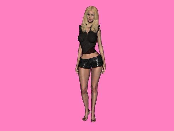

Why do I get these gaps in the skin (on the thighs)? More importantly; how do I solve it?
(The gaps only show up in the render).

  • SimonJMSimonJM Posts: 6,106
    That looks like it would be a UV map/seam issue - check that the UV map set for hips and legs are set to the same, correct, setting for the skin texture in use.
  • Richard HaseltineRichard Haseltine Posts: 111,965
    What is your Shading Rate, in the Advanced tab of Render Settings? If you select the legs or hip with the Surface Selection Tool, what shader is listed at the very top of the Surfaces pane, above the list of surfaces?

    @Richard
    My shading rate is 2.00
    Shader is "default"

    The gaps only occur when I use 3Delight software render. Not in OpenGL (with or without shadows)
    (I can't use OpenGL SL at all. Makes Daz Studio crash, but that is another issue).

    Try dropping Shading Rate - to 1, then to .5, then to .2 - until the seams (hopefully) go away.

    @Richard
    Thx, that did it.
    What does the Shading Rate actually do? Noticed that is distance dependant. The further away the lower I have to set Shading Rate.
    If I am close to the figure I can use a significantly higher setting.
