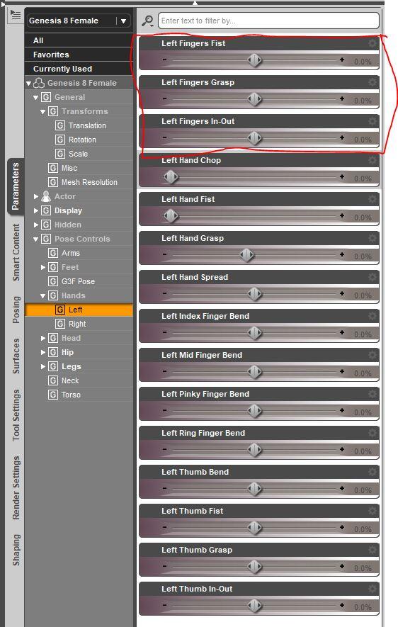

    There are various dials under I believe it was the poses tab, I'd have to go back and look, under 3DU_.  The first promo gives you a decent idea of the variety of sliders you have.  What the sliders alow you to do is move a group of bones into a predefined postion (gradually, you don't have to use the whole pose) without having to move each bone separately or do IK with pinning.  Since the dials cover a wide variety of what you would be using IK for, it makes it quicker to pose, and is really a lot more natural looking, although it is possible to use the dials in combinations that have the body intersect itself (left hand through the right shoulder for example).  I haven't used the piece that transfers the pose created to a static pose yet so I can't comment on how that part works.
    It will take some familiarization with what the individual dials effect to use the product effeciently, but it doesn't look like all that steep a learning curve.
    There is one dial for each hand that allows you to curl the fingers as a group, I've been hoping someone would do that again, the last time that was rigged was for V4 with keygrip.
    There has always been pose controls for the hands to affect the whole hand
    Gradually?  There have always been hand poses, but I haven't seen anything that allows you to gradually curl all the fingers at the same time.  Where did you see that?  It's quite possible I missed something.
    For example:
    562 x 885 - 103K
    Post edited by barbult on
  • Thanks, I completely missed that.  Documentation is a lovely thing... surprise
