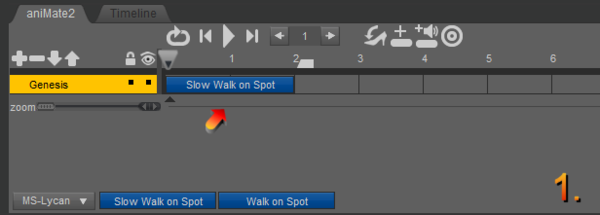

Image #1: Animate2, Genesis Loaded, MS-Lycan AniBlocks selected, Slow Walk on Spot added to Timeline.

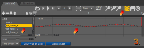

Image #2: Arrows left to Right, Slow Walk selected, Key Frame Edit opened, Animate Graph Editor appears on AniMate2 interface.
Image #3: Arrows left to Right, Hip node of Genesis expanded and X rotation active, Graph of rot_force_x Key Frames, Graph Editor open.
In the rot_force_x Key frames, Select ALL with bounding Box, set VALUE to Zero. No more X rotation in the WALK block.
