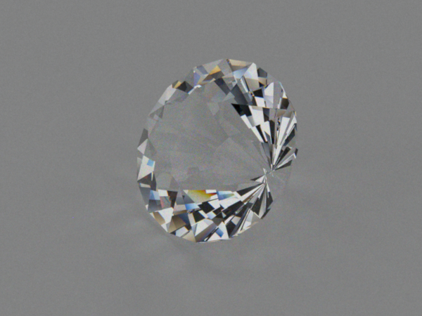

I'm very exited by the ability to use LuxRender from within Carrara, though I'm still just starting to learn how to use it. One of my test renders is using a diamond in the shape of a brilliant. It renders fantastically in Blender using Diamond material from the LuxRender material database. I actually used Blender to decide if I wanted to have Luxus fro Carrara. Unfortunately I cannot get the same results using Glass 2 in Carrara.
Now I have difficulties using the same material "Diamond" from within Carrara. I cannot select Diamond, because it is not one of th provided materials. I cannot select this material from LuxSurface using Material "diamond" (gives error: Static loading of material 'diamond' failed.).

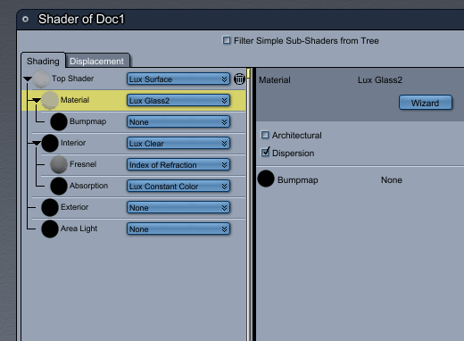

    Try this setup:
    - Lux Surface
    --- Lux Glass2
    ----- X Dispersion
    --- Interior:Lux Clear
    ----- Index of refraction:Diamond

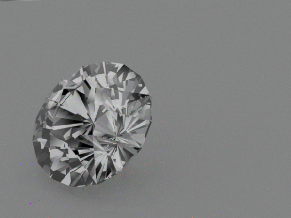

    That is of course what I tried. You can see the difference in the images I posted. The first image uses diamond material through Blender, th second one uses glass2 using carrara. Both of course rendered using Luxus and LuxRender. As you can see, the colored light is missing in the second one.
    The diamond material defines a new interior called diam.
    640 x 480 - 385K
    640 x 480 - 407K

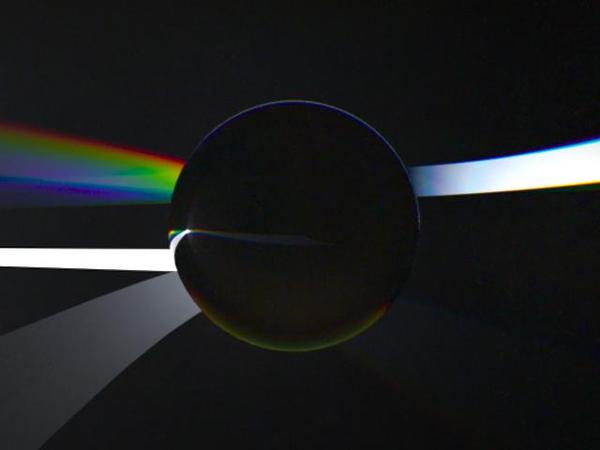

    Instead of using Glass2, use Glass and set the "Cauchy B" value to 5-10%, this gives colour dispersion. I have attached an example, generated with a single beam of white light.
    Will try this as soon as I can.
