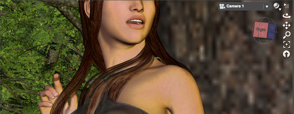

I've been looking through the UI for something that disables leaf shadows or anything else that might be causing the patterns to show up on the skin. The patterns are not there in the editor(2nd attachment), but appear during the render(1st attachment). Its not making any sense to me.
Thanks for any ideas ...

    I will guess at render settings for the lack of lighting information.
    What is your Advanced Render settings Shading Rate set to, the default of 1.00 won't be enough for some renders, try 0.20 for better quailty, Yes lower is better with the Shading Rate and this is your main (though there are others) quality setting.

    If your not worried about render time you can set it to .10

    I followed your notion and found that there is a light element of the Forest package, UberEnvironment2, that was source of the unwanted shading pattern. Once disabled, it looks like I needed it to look.

    UE2 is a shader lighting system, and defaults to lower quality so as to improve render times. You can increase the quality by using the presets which can give a really good effect, but obviously this takes longer to render. While it might not be suitable for all images, I hope the initial quality settings haven't put you off using it completely. It really is a great way of adding ambient occlusion to a render, which fills in those fine details nicely.
