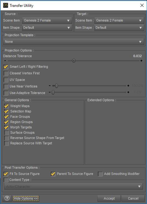

I am quite a novice in modeling and I am facing now a little problem with a pair of earrings I created in Hexagon. I try to explain it step by step.
1. I modeled a very simple pair of earrings in Hexagon
2. I exported it as an OBJ file
3. Now I imported the earrings OBJ file ( In Daz3D I had the identical character as in Hexagon for modeling)
4. The earrings appeared in the Viewport, where I expected them (at the ears)
5. I started the Transfer Utility and set the parameters as displayed in the picture below.
Parameters set in Transfer Utility
6. Then I applied any pose and got the following result. The earrings were deformed.
Deformed Earrings
Obviously I did something wrong or missed a crucial step. Thanks for any hint in advance.

  • LeanaLeana Posts: 13,650
    For earrings like that I would not use the transfer utility but simply parent them to the ears.
    As for why they distort, since the hoops are quite big my guess would be that the transfer utility template used (default one) has "split" the hoops in sections related to different G2F body parts, so the "top part" probably follows the head and the "bottom part" follows the neck, which would explain why it distorts when you move the head.
