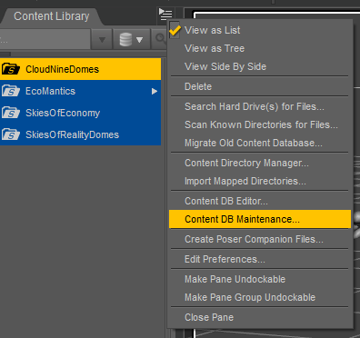

  • JaderailJaderail Posts: 0
    Here tjohn just do this, to get the Metadata back, and then in Task manager Find the Content Management Service and SET it to Run at system boot.

  • TJohnTJohn Posts: 11,448
    Jade: OK, I did that and CMS is running at boot up.
    And as soon as I double-click on the DS 4.6 icon "Running" changes to "Stopped" every time. Something is interfering with these two things running at the same time. And although I can change the State back to running, it still won't display the Metadata.
    Something is borked, my friend. :)

    Great advice guys, and I wish I had come back here to look first, but here's what I did:
    Contacted Norton Support and worked with them online and they turned Norton off. Nope.
    Then they completely uninstalled Norton, and the problem remained. So, not the anti-virus.
    Norton reinstalled, and then I thought about it for a while.
    It occurred to me that one of the things I had tried was "Reimport Old Content Database" (I'm probably not getting the wording correct on that, but I've got a render working right now, so DS is not accessible at the mo.) and when I tried that I kept getting an error.
    Suddenly I had a "forehead slapping" moment. The old content database was corrupt, so DS couldn't read it or rebuild it (duh).
    Scanning the C drive for "database" led me right to the file you mention, which I deleted.
    Fired up DS and then proceded to follow Jade's instructions again and voila! 4 hours later (I've got a lot of Content. LOL) my Content Library/Products and Categories lists were all back, including my precious Smart Content.
