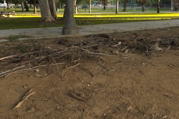

The software isn't the problem. Attached is a render of an empty scene with DTRRO Park P 8k loaded in the environment. All parameters default. Doesn't require any textures loaded, tiling changed etc.
