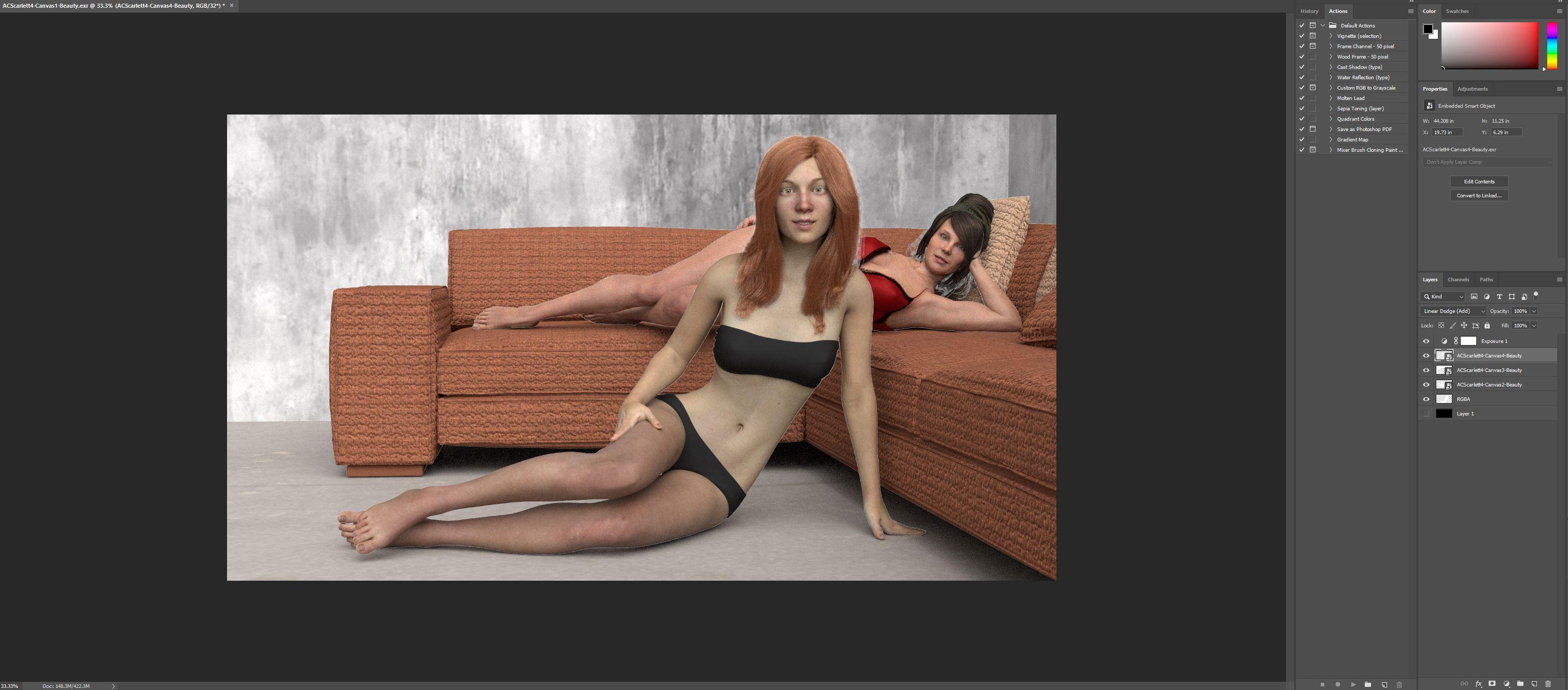

Just have a quick question, when I render two things separately (such as a character and a background) using Canvases and then try to combine them into one image, there's a transparent edge around the whole character that can't really be removed. If I turn off Alpha in the canvas rendering, it comes in against a black background, which I know can be hidden by switching blending modes in Photoshop to Lighten, but that leaves a few odd edges too.
Is there a recommended method for combining elements that are rendered as separate canvases? Thanks.

    TheKD, I actually tried that but because the background also has transparency where the figure was, trimming the figure just adds more transparancy to the background.
    Shane: I just re-rendered the two elements and also made an LPE render, will experiment further and see if I can share them if I still have no luck. Are you suggesting I work with the HDR canvas renders or the basic PNGs (I've really only tried with the PNGs so far)? Thanks in advance.
  • SnowSultanSnowSultan Posts: 3,832
    OK, I did a bunch more tests with canvas renders, normal renders, whatever LPE renders are, cutting, pasting, and trying Blend If... options and can't fix this problem. Here are two small cropped examples of the transparency halo that I can't seem to eliminate. Renders are of my character in a room (character and room rendered separately). You can clearly see the large transparency problem with the fluffy hair.
    Any advice is appreciated.

    Richard: Remove matte doesn't work in this case because the background has a transparent area where the figure should be. The halo around the figure could be removed with postwork, but it will just enlarge the transparency that's 'behind' the figure, rendered into the background layer.
    I see I'm not the only one with this issue. The advantage of rendering with canvases is that shadows are still rendered as if all objects were visible, but this issue with compositing makes that feature useless. I still plan on rendering the whole scene in one normal render and set up 3Delight masks to select everything individually, but I was hoping this might provide a more modern solution.

    OK...this is weird. I rendered two canvases (character and background) with default settings and saved each as a TIF instead of PNGs. When loaded in Photoshop and the character render was pasted onto the background one, the halo was still visible. However, if a solid black layer is added beneath the background one, the halo completely disappears - and the strangest part - the new black layer is not visible where the halo was. It *is* visible if you follow these same steps with PNGs; a clear black outline appears around the figure and the hair looks awful.
    Could this have something to do with how TIFs handle transparency? I honestly have no idea why adding the black background does *not* create the outline effect when used on TIFs when all logic says it should.

    Shane: Yes, I tried putting a black background layer with PNGs and the halo remains. That's what is so strange, what are TIFs doing that PNGs are not?
    As for the canvas renders, I'm doing normal Beauty renders with only HDRI lighting (no scene lighting).

    Lol...well I am getting dark artifacts instead of Halo's:
    TransparentBG
    BG
    I am investigating...
    **UPDATE**
    Found the culprit...using exr-io there is an option that was checked causing the issue. Make sure that if you are using exr-io when you open an exr image to make sure that "Fix transparent light emitters" is unchecked:
    Setting
    Now everything looks right:
    BGFixd
    TransparentFixd
    For these I just opened the Beauty.exr canvas in photoshop and used an exposure layer to bring it back to my tone map setting (negative value) and all was as it should be, as long as I had unchecked that option for light emitter from exr-io. I hope something from here helps.

    Alright, results of second, all new scene: exactly the same as the first.
    (note: I forgot to add the little gold rings around the horns to the character's canvas node, that's why they're transparent. That's an error on my end.)
    First one is the default look when a character canvas render (TIF) and a background canvas render (TIF) are layered in Photoshop CC. Layers shown in next image.
    Second one shows what happens when a solid black layer is added beneath both rendered images. Layers also shown.
    This 'fix' does not appear to work with PNGs, only TIFs. I'm going to render a normal non-canvas image later and compare it to the 'fixed' composite shown. Also tried every blending mode on both renders, nothing removes the halo because the halo isn't caused by bright pixels; it's actually transparent areas that are larger than they should be.

    I was able to reproduce. For me it was simply putting a black background below everything else. I had 4 separate canvases using 4 separate node selections, all alphas. Below are the 2 different results, one with black background and one without...This was with the 32bit exr's:
    NO BLACK BACKGROUN:
    NoBlkBG
    WITH BLACK BACKGROUND:
    WithBlkBG

    AlmightyQuest is right, as I said before, this isn't an issue with white pixels, it's that Studio is rendering the transparency one or two pixels too large when using canvases. I'd like to know why placing a black layer behind the layers makes the transparency on TIFs go away - it's possible that has something to do with how Photoshop reads TIFs - but yeah, I don't want to install another program just to test that.
    edit: Oso, I get the same results with EXRs regardless of how I try and convert them. I don't think I've tried putting the black background layer behind two converted EXRs, but since it works with TIFs, I haven't bothered.
    To be honest, I'm not sure why we need to render elements separately on canvases unless your PC can't handle rendering a whole scene at once. Masking gives more options because you can mask each surface instead of entire objects, and it isn't like you can animate characters from canvas renders because the background will retain the transparency where the character should be. This really is just a curiousity that I'd like to understand, but probably isn't worth all this trouble. Thanks to everyone for your help and suggestions so far though.  :)
