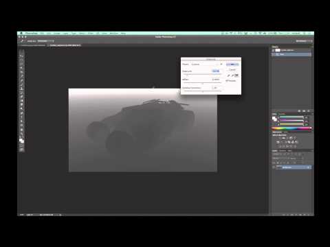

  • This was the video that I learned from for using the Depth pass. It is from different rendering software but the post work in photoshop is same.
  • wsgentrywsgentry Posts: 573
    I'm going to try that and report back.  Thank you!
    Scott

    It works somewhat.  One thing that's not covered is the disparity of color bit-depth.  In the example, the bit depth of the original image with no blur is 8-bits.  The depth exr is 32-bits.   When using the Beauty EXR as the image, after performing all steps--except the Lens blur (it is grayed at 32-bits), it's way dark.   So, I'm going to bring in the original render and do the rest of the steps so I will have an 8-bit BMP and a 32-bit depth exr.
    Oso3D,
    I'm getting there.
    Edit:  It works with an 8-bit original and a 32-bit depth layer.  Thank you!
    Now to figure out how to get it to work with masks and non-destructive editing.
