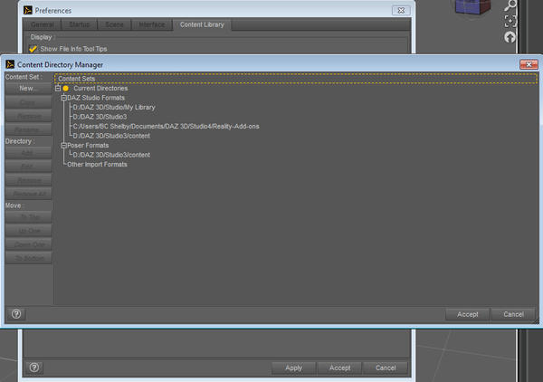

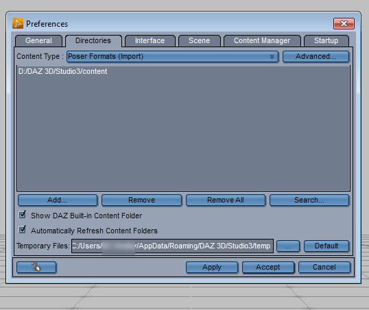

    Can you post your Content Directory Manager listings for Poser format for both DS3 and DS4 (Edit > Preferences > Directories in DS3, Edit > Preferences > Content Library in DS4)?
    ...currently on the notebook. Give me a few minutes to get online with the workstation.
    ...OK the first one is the DM listing for 4.6, the second for 3.1 Poser Format

    I suspect the problem is having D:/DAZ 3D/Studio3 listed under DS-format content folders in DS4.6 -- that since the Runtime folder is not directly inside that folder, it's seeing it as DS-format and getting confused.

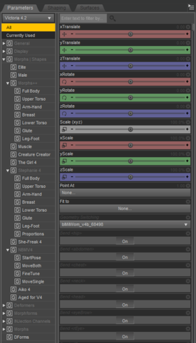

    BIG EDIT: Here is my V4 done with a DIM only install to a DIM DS Folder. I see no reason to BREAK the content into DS folders and Poser Runtimes. I Point my Poser 9 to the RUNTIME in the My DAZ 3D Library and it loads just fine. As You see all my morphs load in DS.
