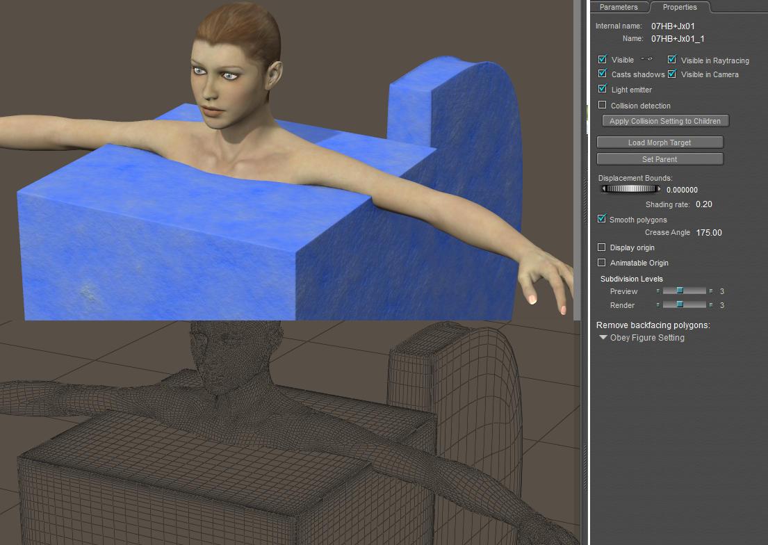

I recall reading somewhere that dNdu etc only work properly if you're using smoothing - i.e. 'Smoothing' ticked* in render settings and in the prop's parameter tab, and crease angle set high enough to prevent any creases.
So I tried using my attempt at the shader with a couple of props and SubD.
It doesn't work.
Can anybody see any mistakes in my recreation of the shader ?
