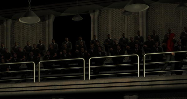

I would like to do this really big scene I have in my mind. I won't say exactly what it is but it'd be filling about 250 seats. I do have most of the LoRez people. I'd have to see how much I can customize.
So feasible or know to do a scene with 250 low rezzes plus others? now I also thought about doing the scene in passes where I render different sections and then splice them together. I've never done that but I'm trying to think outside the box on this one.

    I think that 250 individual figures would be ambitious, although using the LoRez figures might just make it possible. As far as I know, Studio doesn't support instancing, where you can have multiple copies of the same object at different locations. Send in the Clones will clone objects, but it will actually produce new copies, each of which takes up memory.
    I use Carrara's replicators a lot for crowd scenes, such as this one and this one. In those examples, all the figures are posed identically and drawn up in formation, using single figures and simple replicators. Attached below is a slightly more complex example, a fragment of a WIP using LoRez figures and multiple replicators. You could, however, make a fairly convincing 'mob' by using multiple different base figures, and a surface replicator (which allows random placement of the instanced objects).
    But that's Carrara, and you want to use Studio, so I'm not sure what to suggest, except huge amounts of RAM and a great deal of patience.

    Yes Daz Studio does have Instancing now and has done for a year or so.

    In that case, there's a solution. Provided not all the figures need to be visibly distinct (i.e. different poses, appearances), you should be able to crowd your scenes with figures to your heart's content.

    My pleasure. Even though Instancing reduces memory needed it will still use up a lot of memory with a lot of instances but it should help with rendering larger groups that without using it.
    You could also use a Geomtry Shell which is just a plain basic mesh with no movement or morphs, a clone if you will but with one added bonus is that you can use different textures as opposed to Instancing where you cannot change textures. So you could Instance the distant crowd and as you get closer to the camera you could use some Shells and change the textures to make then look a little different at least.

    Don't know how complex the scene will be but I'd try to render the people row for row and then add them together in PS or Gimp.
    Start from the back should work.
    This way your audience won't look so static as you can pose and differ them.

    I was wondering about instancing. I have used that before. I want the "crowd" to be distinct enough that they all don't look the same but duplicates and triplets will be fine if I can space them out.
    I'm going to do some experimenting this afternoon to see if what popped in mind will even work. I'll know shortly. If not, I may have to try it a little different way.

    I've tried instancing G2F. At 100 DS takes a bit more than 1Gig memory but the interface becomes sluggish. At 150 it becomes unusable. Instancing works great when not displaying the instances. The problem may come from either smoothing modifier or the graphic card can't handle all the instances. Side note I have 8 Gig Ram and 2 Gigs VRam
    Another way to do that would be to render little scenes in RIB files and to a final render with 3delight standalone which will be just reading all RIB archives
    I'lll post something about this method later. I don't know yet how that will handle memory.

    Instancing works fine, but be aware of the limits: instances inherit the texture, pose and morphs of the parent and apart from individually adjusting their X, Y and Z Translation and Rotation (also Scale? not tried that yet!) they will be the same as their 'parent' More good news is that if you have a clothed and haired figure the instancing will take over all of that, too - presumably it will do so for all conformed items (not checked parented props yet).
