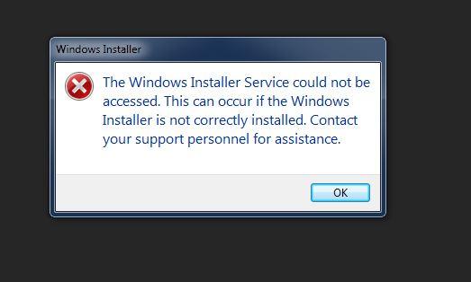

I cannot seem to get Carrara 8 to run. I had Carrara 8.5 beta installed, but from what I understand the beta is over. I am trying to uninstall all versions of Carrara, but with no success. I keep getting errors when trying to install Carrara 8 again.

    This is the error I get when I try to install Carrara.
    523 x 314 - 28K
  • SpacelandSpaceland Posts: 132
    I have Windows 8 and i have installed the same version.
    did you try to delete manually, all daz folders from the c drive?
    before doing this, make certain to back the folders if you have any contents.
    try that if you have not http://www.ehow.com/how_7855031_restore-windows-installer.html
    let me know.

  • DUDUDUDU Posts: 1,945
    … and clean the register too!
  • XyetztXyetzt Posts: 27,546
    Okay How do I do that?
    Thanks for helping despite my erratic behaviour yesterday.
    edited October 2013
    In the Start Menu:
    Execute/types “regedit”
    You are in the register but attention not to do anything wrong!
    If you are sure to have uninstall Carrara completely, you deploy “HKEY_CURRENT USER”, you seek the file “Software” then “DAZ”.
    Inside, you see the programs installed (Carrara8 and Studio4 for example).
    You remove the Carrara file.
    You make the same thing in “HKEY-LOCAL-MACHINE” but I do not believe that DAZ places something there.
    It's only for the register but there are many places where are some files on the "C" drive as Spaceland said...
    I cleaned the register like you said and then tried to reinstall Carrara but there were no new entries in the register.
    Do you have restarted your computer ?
    How works Carrara now ?

  • tbwoqtbwoq Posts: 238
    Hi Kulay Wolf.
    You shouldn't need to reinstall other programs or restore the system if Carrara is the only program having the issue. Try and uninstall the, Microsoft Visual C++ 200x Redistributable files, then reinstall Carrara and see if that helps.

    I understand that restoring a computer to factory setting for one problem seems to be over dramatic. I am having problems with several programs. My security system and the cms do not want to start on their own when I start the computer. There are other problems that are frustrating me such as firefox keep freezing up. DIM sometimes freezes and has to be closed and reopened so I can finish what I was doing. I have a lot of unneeded programs that won't fully uninstall. ect, ect, ect.
    How do I get Daz Install manager to install Carrara content? I reset the computer to factory setting. Carrara installed perfectly but I could not get the content to install.
    You need to tell Daz Install Manager, in the settings, Tab Application and Add Carrara version with the default folder for carrara.
