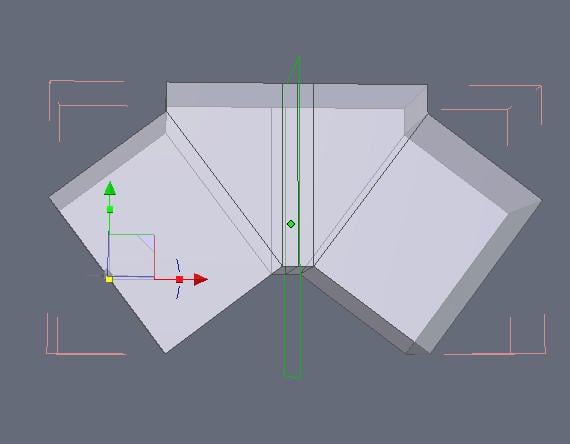

    1. First make sure that the figure you are modelling for is locked so you don't select any part of it. Draw out a cube and size it to roughly fit from the hips to the crotch. Select a horizontal edge, ring-select and connect. With the new vertical edge selected, extract edges around - keep them close - you now have three vertical edges running right around the cube. Pic1

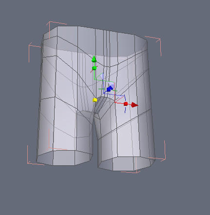

    2. Delete all the top facets. Hide the figure and resize the the cube in the X and Z axes, so that the bottom factes which will make up the legs are perfectly square - this is very important, because square facets will become round when smoothed. The cube will no longer fit the figure - we'll get to that later. Go into symmetrical mode. Select the outer verts and drag up, to form a bikini-type shape. Pic2

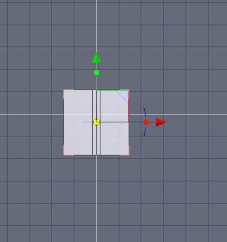

    3. Select the face on the side of the bikini and extrude downwards (hold Ctrl and drag) - rotate the faces and pull them towards the centre, pull in the outer verts and get all the bottom verts to line up on the Y axis (select them all and in the properties panel set size on the Y axis to 0. Pic 3.

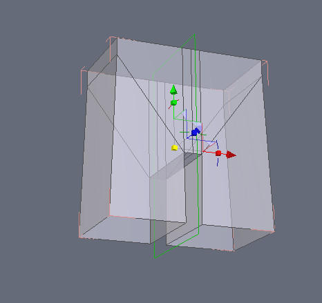

    4. Delete the leg facets, smooth level1 and collapse DG. Pic4.
    5. Re-set symmetry, unhide the figure, resize the pants to fit - this is where you start pushing and pulling verts and facets (use soft selection). Once it fits snugnly, you can extrude and shape the legs.
