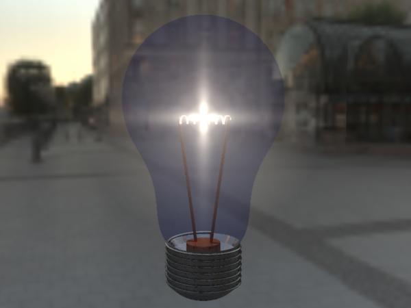

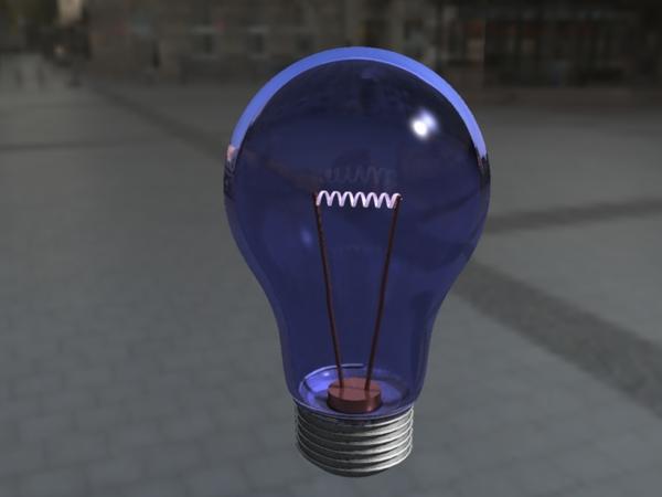

Hi all.
I'm trying to do something rather simple, but can't figure out how to get around an issue I'm having with light effects.
I modeled a bulb (a real one, not a Carrara one!), inserted a Carrara bulb light inside the glass, and set light effects.
When I rendered, I discovered the light effect doesn't work when it is inside anything, even if the object is transparent (like the glass bulb).
I can't seem to find a way around this. I've tried everything I can think of, even the "Restrict lighting to: All objects except:" and selected "bulb glass".
I'm hoping this is just a goofy thing I'm forgetting and not a Carrara limitation. Any thoughts?
Thanks!

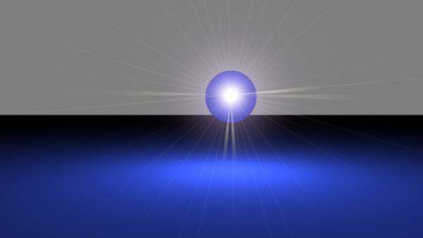

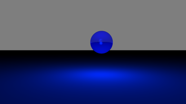

    Hi FractalDimensia, for me it works (example shows a blue glass (Poly) Sphere with a bulb in it. No other Lights in the szene.
    Edit:
    Make sure
    Bulb is visible
    Falloff is is disabled or the value is high enough
    Bulb brightness is high enough
    and Light Through Transparency is enabled in Renderroom!
    I'm shure it is only a simple thing
    Edit 2
    Sorry, I misunderstood the question! The lighting effects do not work for me too! :red:

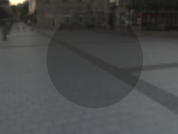

  • EddyMI3DEddyMI3D Posts: 365
    Also have a look that translucency is set in the glass shader.
  • mikomodamikomoda Posts: 0
    I have found, that if you set the transparency value and the more transparent the material is, the more the light effects come visible!
    In this example the value of the glass material is transparent to 70% (Effect: LensFlare) The Values of the LensFlare needs to be increased.
    Maybe this helps!
    720 x 405 - 111K

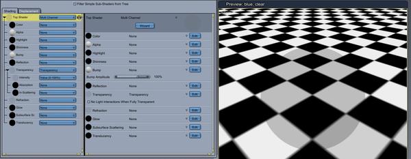

  • FractalDimensiaFractalDimensia Posts: 0
    I took away everything except for transparency, set it at about 80%, and still no effects.
    See images below.
    1305 x 507 - 161K
    640 x 480 - 66K

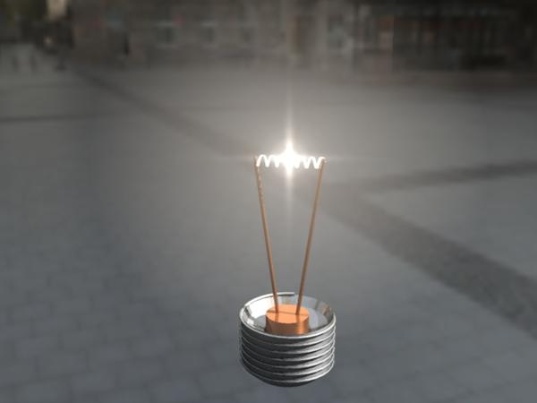

    Also, adjusting the Alpha channel only works for "Lens Flare." I was attempting to use other light effects - specifically, CrossScreen and Glow. These STILL do not work even by adjusting the Alpha channel.
    It seems I'll have to just stick with Lens Flare. :( Too bad....
    edited October 2013
    I take that back, LOL.
    You really have to jack up the effects to get them to show through the object!!
    640 x 480 - 93K

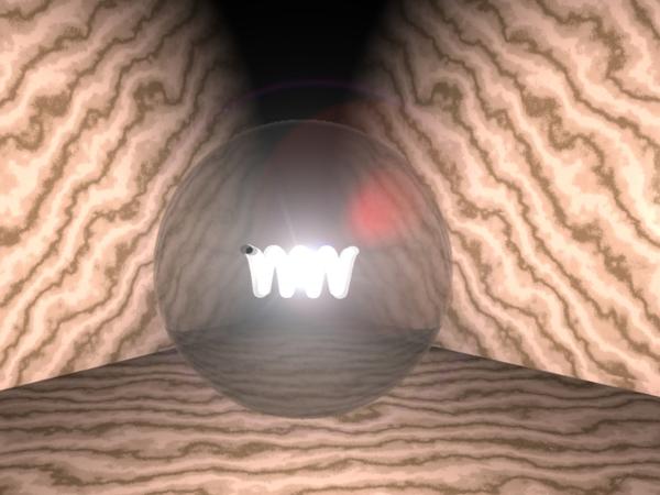

    edited October 2013
    Following this thread, my suggestion would be to set up your glass shader for the bulb with your transparency, reflection and refraction the way you want it, then set your alpha channel in the shader to around 50%. That way, you can still see the effects of the shader, and still get your lens flare and other effects.
    In addition, I would use the 3D light sphere. It's visible no matter the alpha setting. Set the effect to Realistic and play with the intensity, diameter and quality settings. It can look really good and can help hide the point of origin of the flare or other effect, especially since the filament is long and spiraled, and the bulb light is a single point.
