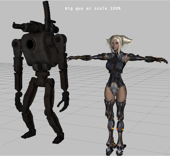

    Thanks for the response! To clarify, I'm using Daz 4.5 (64 bit).
    After some further examination I determined it was the Scale parameter of the robot causing the problem. If I scale him down to 100%, the V4 I'm trying to parent to him doesn't have any issues. I raised his scale up to 200% to exaggerate the problem and it became obvious that parts of the V4 were trying to scale as well. The 200% scale picture below shows this.
    Any guesses as to a workaround?
    935 x 863 - 301K
    935 x 863 - 326K
  • Richard HaseltineRichard Haseltine Posts: 111,348
    Odd, I am using the latest version (4.6.1.17) but when I parent Genesis to a scaled figure (Genesis 2 female) I either get no change (Parent In Place on) or the figure scales to match the parent (Parent in Place off). Is this happening whatever you use as a parent or is it unique(ish) to the robot?

  • edited December 1969
    Richard, I tried to do what you did (parenting to a scaled Genesis figure) and I experienced the same thing you did, but the clothing fit was still wacky. I wonder if this is because V4 has no scale parameter? StratDragon's technique seems to have done the trick however, so I think I'm going to progress with that and see how it goes!
