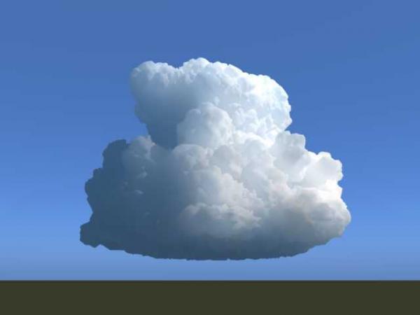

I have tried to make cumulonimbus clouds with Carraras volumetric clouds, 4D clouds, clouds and also with Inagoni primvol, unfortunately I did not have much success.
I just found a promising solution on share cg, It is a Carrara vertex modeled cloud. With this cloud it will be possible to add morph targets & bones to change the cloud shape......I have yet to join share cg, but I would like to give this model a try.
http://www.sharecg.com/v/41244/related/5/3D-Model/Cumulonimbus-cloud
Just sharing what I found for others to try out.

    how do you get it to render that way?
    I DLed this model a long time ago, and the promo images are accurate! It's a great model.
    The cloud is actually a metaball object converted to a vertex object and probably cleaned up and modified. It's really interesting to look at.
    The shader is even more interesting. The author of the model and shader uses SSS, the glow channel, displacement, etc.
    It's worth the time to register and DL in my opinion.

    Wow.....
    I didn't realize that I already had a sharecg account....anyway, I am using C8.1 and the cloud renders great. The mesh looks like the main part of the cloud is made from a sphere....possibly some metaballs around it.
    What is amazing is the shader and displacement....the shader makes it really nice.
    I will work on a vertex (box modeled) cloud....maybe morphs or bones....see what is possible with it. :)
