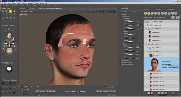

I am trying to release a character for M4 but the head morph failed testing. Me and another vendor are collaberating and he doesnt know whats wrong either. He is the one making the inj poses.I was wonder can anyone help? The eyebrow seems to be the problem.

    Here is the screenshot of my problem.
    1200 x 643 - 200K
    Looks like your inj pose may be turning on the visibility of M4's brow prop, which is normally hidden unless it's being used.
  • 3D.a.l.i.3D.a.l.i. Posts: 32
    Thanks for your reply. Any ideas how I can fix it?
    edited October 2013
    When saving the inj in Poser, use the Select Subset button to uncheck the eyebrow portion, that way the visibility state of it isn't saved within the inj pose.

    Actually I may be wrong. I double checked with other morphs I've got, and whether the brow prop is off or on doesn't do this.
    yes I was thinking that. I wonder what I can do?
    edited October 2013
    Not sure, hopefully someone else knows. I can't even get it to do that with my own morphs (using the obj from geometries). The only way I'm seeing even a hint of the eyebrows, is if the specular and highlight size and everything is on white and cranked up in the mat room (on the brow zone), but even then, the brow prop conforms and wraps with the morph, not sticks out the way yours looks like it's doing.

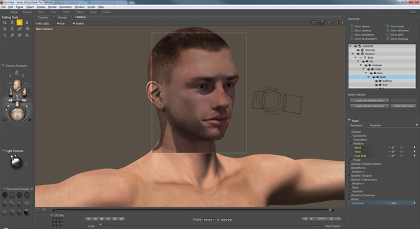

    Ok. Loaded up M4, spawned the morph target based on your OBJ file, flipped on the brow prop, and everything looks fine on my end.
    (from here, personally, I would save the CR2 with binary morphs on, then use Binary Morph Editor to create the inj/rem scripts with the PMD data saved right to the inj/rem files, but that's just my personal workflow)
    /edit
    I went a step further and did my inj/rem creation just to test and it works fine. It seems to be something in whatever whichever one of you is doing, since I'm working from the same morphed obj as you.

    I am the vendor helping out 3dali with this character and just wanted to confirm the issue is not with the head morph per se.
    The INJ is not making the eyebrow visible, I think the tester is turning on visibility manually and are pointing out the fact it does not conform to the head morph.
    We need to figure out a way to get the eyebrow part following the curves of the head morph.
    I have never known this be an issue with characters in testing before but I believe that is what we are up against now
    Post edited by retrodevil on
  • Richard HaseltineRichard Haseltine Posts: 110,645
    You will have to create a morph for the brow, it's a separate body part so if you are working in Poser you will need a separate OBJ for it and use ERC to slave it to the head morph, or make both part of the same FBM.
