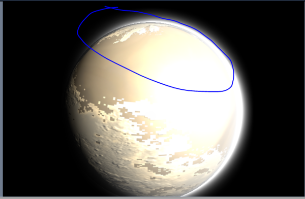

Something weird, I am following a tutorial done by Kixum from Renderosity. (old tutorial on planet).
Anyway, in the finish, at the final render, its planet show round and anti-alias done correctly, but on my planet when the glow is calculating and done, I see that anti-alias is not done.

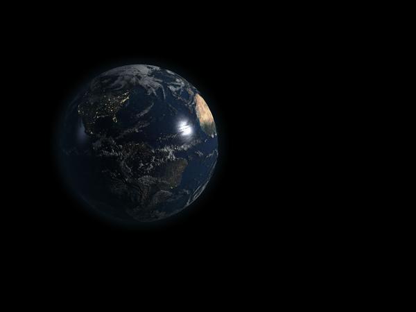

Attachment, capture is my test planet
Render settings is set to:
Anti-Alias = Best
Object and shadow accuracy to be 0.5 pixel

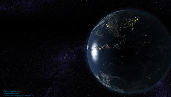

Attachment capture 2, is the render from the owner tutorial.
Is there a possibility that he done post work on it or I am missing something?
I am using Carrara 8.1.1 Pro Build 12 (32 or 64 bits) does the same.
841 x 363 - 338K
647 x 423 - 199K

    No forget about the cloud, the problem arise only when Aura is use for the halo sphere, there is no anti-alias being apply to that sphere or in the aura itself.
    Test done with carrara sphere and done with a higher detail sphere in obj with more polygon.
    I did another test at 1366x768.
    When the render is done, we do see the sphere and anti-alias apply properly, then Carrara calculate the Aura being apply to the halo sphere only and when it is done, it is only the halo sphere that I don't see the anti-alias being apply.

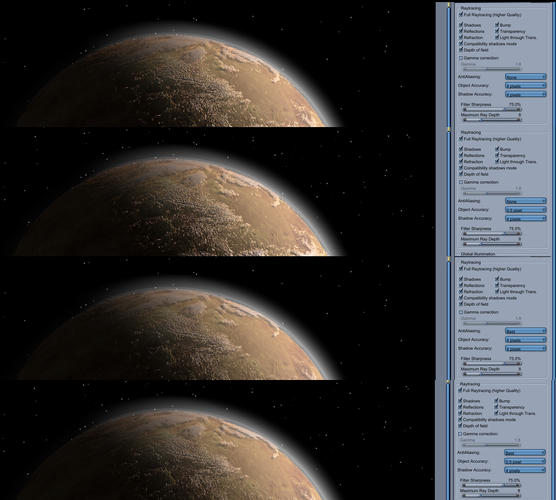

    I'm going to muddy the waters a bit. I think it's the Aura that is the issue, but I'm not sure why as I have used it before for "atmosphere," without an issue.
    Here's one I did. I either still have the scene or the model, so I'll take a look at what I did for the aura in a bit.
    2000 x 1133 - 1019K

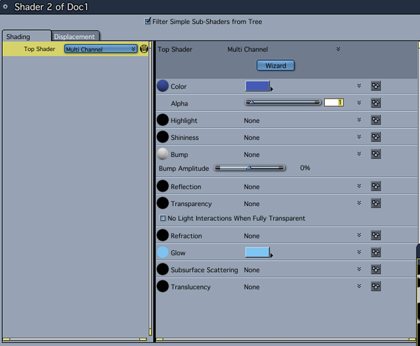

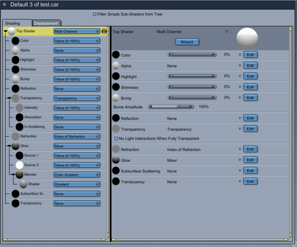

    The shader

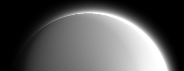

  • SpacelandSpaceland Posts: 132
    That is what I am thinking.

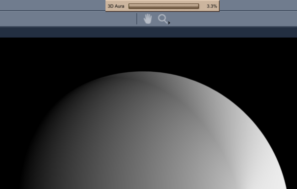

    Look at the 2 capture I did, before aura and after aura is apply
    769 x 298 - 88K
    656 x 418 - 38K

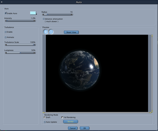

  • DUDUDUDU Posts: 1,945
    I do not know your adjustments of colors but it is not the Aura it responsible.
    Here, a simple nonpolygonal sphere. Image: 640x480.
    640 x 480 - 30K

    I think what's going on is that you are applying the glow to your cloud layer.
    What I did for my model was have three spheres. One for the planet, one for the cloud layer, and one for the glow alone.
    This is important! The sphere that I used for the aura is only one point larger than the sphere for the clouds! So let's assume the cloud sphere has a diameter of 20.00 ft. The sphere for the glow would be set to 20.01 ft.

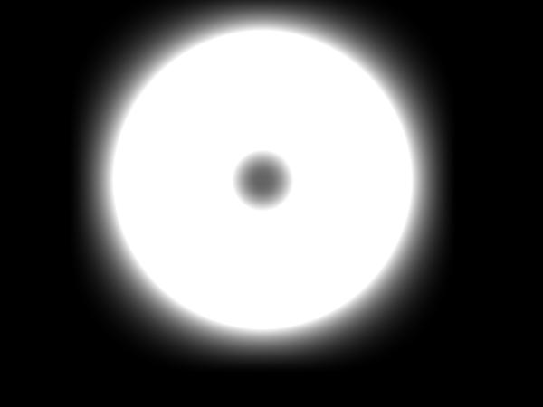

    Here are the shader and glow settings I used for the sphere with the aura.
    2000 x 1500 - 336K
    892 x 736 - 125K
    666 x 549 - 56K
    Yes, it is possible for the effect to be caused by the aura. I've had it myself. I usually have issues with it and alphas in certain cases, such as when a glowing object is peaking out from behind another glowing object that has an alpha channel. A good test for this is to open the smoke particle emitter and apply a glow to the particle shader and the aura to the emitter. You'll see exactly what I'm talking about as the particles with alpha will display all sorts of aliasing issues.
    Your glow setting outmatch the sphere, it s like hiding in the glare.

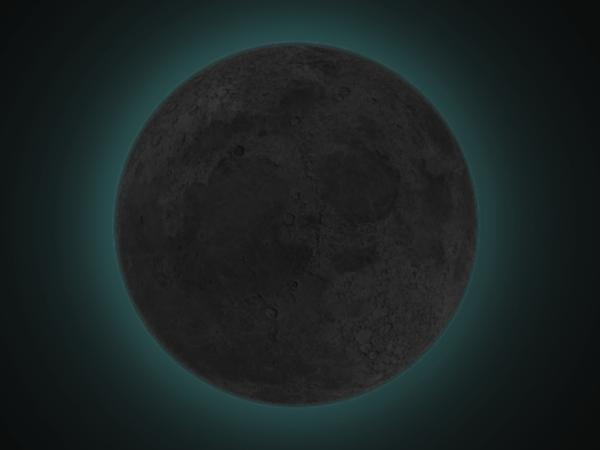

    I wanted to finish this topic by a total eclipse!
    Thanks to your aura …
    640 x 480 - 86K

    First, I don't patrol the DAZ Carrar forum very often and I just happened across this post.
    The root of this thread was to discuss the pixelation which is showing up beneath the aura in a planet tutorial I have posted over at Renderosity. I am a little surprised that nobody sent me a message concerning the tutorial in the first place but no biggy.
    Carrara 5 made some changes which messed up the 3D aura tool. Carrara 4 and older rendered the 3D aura with much better results. I don't know what got changed but it's been twitchy ever since with hit and miss results.
    I pulled up the original file and did four separate renders which I am posting the most important factors here. The four renders show results with anti aliasing and pixel accuracy set to their extremes with all four possible combinations.
    I have moved the camera to attempt to maximize this effect. There is no postwork in my original render nor in the renders you see here.
    From some viewpoints, this pixelation issue can be more extreme than from other viewpoints. It's an issue of how bright, how distant, and the view that's used. The problem can be very sensitive to the size of objects. It's my personal belief this happens because Carrara's coding utilizes some kind of mathematics which have divisions in the geometric calculations that suffer numerical anomalies (a significant problem I have reproduced in several aspects of Carrara). When Carrara has been upgraded into higher bit versions, some of these anomalies have been exaggerated while others have been subdued.
    I have been able to reproduce this problem as identified in the original posting of this thread. My initial suggestion to solve the problem is to make the planet larger in the scene by a simple rescaling and try to re-render. As you can also see from what I've posted, anti-aliasing and pixel accuracy can impact the results.
    I have posted a sample file in the free stuff over at Renderosity which you can retrieve and play with. This halo issue has been a significant challenge for many users and a sample file can be a big help.
    One last thing, the 3D aura (again in my opinion) has some kind of memory leak issues as the times for renders can be extremely long after rendering test renders for a while (this makes no sense to me unless the coding has leaks).
    -Kix
    1340 x 1204 - 909K
