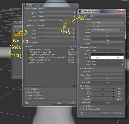

    You could fairly easily create a single master slider for each of the shapes using ERC Freeze, one that would set the components to their full values at 1 and have the base shape at 0, then turn one up as the other was turned down.
    Save before you do this - some people have reported crashes using ERC Freeze though it was OK for me. Apply one set of morphs, open the Property Hierarchy pane, right-click on the figure and select ERC Freeze. Seelct your figure and the root (presumably), make sure your morphs are selected at the bottom, and uncheck Restore Rigging (it shouldn't hurt if you don't, but it's safer) then click the Create new button for property and give it a name, a path (where it will appear in the Parameters pane) and adjust settings (here I set the minimum value to 0, since you wouldn't want to go negative). Click Accept in both dialogues and you should now find that there's a single slider set, controlling all the morphs you sued to create the character. repeat for the other character.
