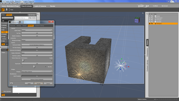

    Well, just sculpting them a little bit to make them look worn. Thought the higher the poly the better to get good results. How would i calculate polys? Is there two polys per face? 3 points right?
    DAZ_cjones, Here is the pic [removed]void(0);

  • DAZ_cjonesDAZ_cjones Posts: 664
    Try changing "Display Optimization" from "None" to "Best". Also, do you have two video card options: an intel embedded and a nvidia? If you do, you might want to ensure the nvidia is the one that is picked.

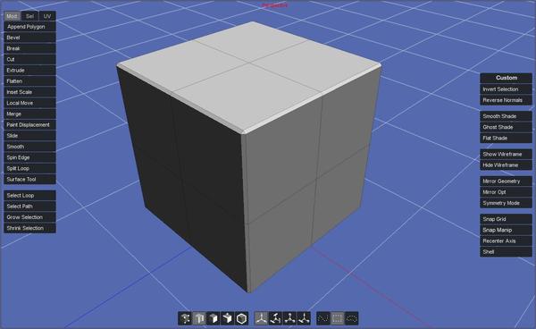

  • frank0314frank0314 Posts: 15,116
    edited October 2013
    BlitzMan said:
    What do you mean 50 polys? 50 polys per...what?
    Faces. If you doing wearing around corners and edges you['ll need more poly than this. In most cases this works just fine

  • edited December 1969
    Display Optimization was it. I thought i had set that to best. lol. Works great now. Thank you kind sirs.
