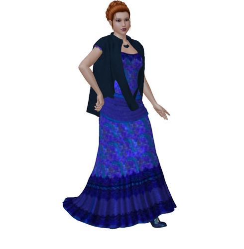

I have made an OBJ, by importing a genesis clothing item into Carrara and then exporting an obj.
I have scaled the resulting obj so it fits V4 in poser,
Now how do I turn it into a working dynamic item.
The OBJ is of the Cape from the Mad nurse set. What part of V4 should I parent it to?
I tried running a drape, colliding it against Neck, chest, collar shoulder and arm of V4, and also the same parts of the dress she was wearing. However it won't drape over her arms at all,(this is in Poser 8 btw) and My Poser 6 manual isn't really helpful.
I also ran a drape colliding against Body, and that was even worse.

    Trouble is that is a sleeveless gown. I have nor problems with those. THe cape It obviously needs to firt over the arms, and this is what I get when I run the drape, despite having the arms selected as a collide against part
    629 x 642 - 85K

    Parenting won't affect how the cloth simulation works. In fact, I'd recommend removing any parenting, as long as your figure is in the default position, in case
    That said, I'm not sure why the cape is passing through the arms. I can only offer a few random questions.
    What does it look like at frame 1, before you start simulation?
    Have you tried selecting the entire figure to collide against - it will take longer to run, but hopefully may reveal if there's something missing from the collision list.
    Did you have to scale the object a lot to make it fit?
    (I'd be happy to take a look at the cape for you, assuming it's distributable. I have Posers 6, 7 and 9 available to play with... Edit - just re-read your original post - forget that!)
