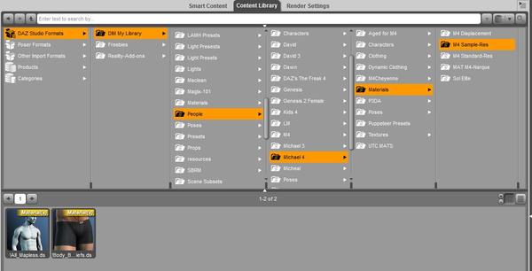

    If you are a DAZ Studio user, you need the StudioCF installer. (CF means Companion File, btw..) Typically they contain optimized material presets for DAZ Studio, though I've seen lights and poses in the installer on occasion, but mostly you'll find materials. The actual model files will be found in the Poser Format's library.
    The StudioCF files will install in your DAZ Studio Formats library. The Michael 4 Base StudioCF files are shown in the picture below.
    PoserCF are needed only if you're using DAZ content with the Poser program and the DSON importer for Poser. If you're installing with DIM and only have DAZ Studio selected in the download filter, you'll never see the PoserCF installers in your Ready to Download tab.

    Something is off on your content installs. The yellow ! means the file or files are Orphaned in DAZ Studio. Which means that DS is not reading the files properly. Are they installed to the same location, content folder, the M4 base files are Installed to?

    Jaderail .DIM installed them and it was part of the Studio software. If I did want to fix it or if I see anymore that came with Studio I would have to uninstall and reinstall Studio? I read something about turning off or uninstall CMS. I would have to turn that off or uninstall that too? to fix my problem? If it show up that was something I bought at the store then I would just uninstall and reinstall that item and not mess with CMS? So far I have not used M4 is it ok not to fix it if I do not use him or does is mess other things up?

    So I'm not sure what that PowerLoader thingie is, but perhaps that has something to do with it too? Which of these got installed? If you want to manually do it, extract the files (you do not drag over the manifest file, that is for the DIM to use. Just the Content, etc) and drag over to My Library/wherever you have your files. When you do this, have the studio turned OFF, and when you open it up again, be sure the Content Management Service is running so the new files are installed.

    Tip: Un-installing DAZ Studio has not one thing to do with content installations. The content is in a totally different folder and only seen by DAZ Studio and the CMS when you, the user, points the DAZ Studio program to the Content folder. Un-installing DAZ Stuido is only needed when a NEW version of DAZ Studio is installed or the program gets a update, at that time the CMS should be Stopped and Un-installed also. It can not and will not FIX Content ERRORS to re-install DAZ Studio unless your download had a error.
    The way content is installed, the place it is installed to and if the path or paths to the content is listed in the DAZ Studio preferences is all that handles content errors. If the CMS is not running the content will still work in the Content Library Tab, not Smart Content, as long as all of the above is correct.
    Example of a possible cause of the Error you have: M4 installed to the default My Library folder DAZ Studio created at install and the M4 Morph set being installed in the Default folder, My DAZ 3D Library, that the DIM creates. One thing many users do not understand is the Content folders and that Some Figures (Gen4's, M4, V4 and Genesis shapes) must all be in the SAME folder to work. I fixed All my issues by using DIM to install EVERYTHING to one big Folder and having DAZ Studio only use that ONE folder for all my content.
    I'm a Advanced user and understand the path needs so I can and DO have other content folders. For users that are not fully up to speed I strongly suggest one single Content folder until the way it works is understood.
