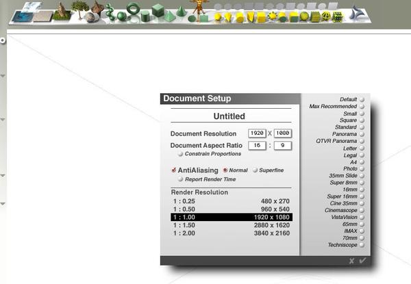

    Q 1: All you need to do is to set up the screen at the proper ratio, which for your current screen should be 1280x720. In the Document Set-up at the top left of the screen, you need to change the Render Resolution to one of the multiples of 1280x720, such as 1920x1080 for example. The Aspect Ratio is locked with a red checkmark until you unlock it. This too will help you get the exact resolution you want.
    In theory by setting it up this way you can keep your working window size minimal while still getting high resolution for the final renders. Hope this helps.

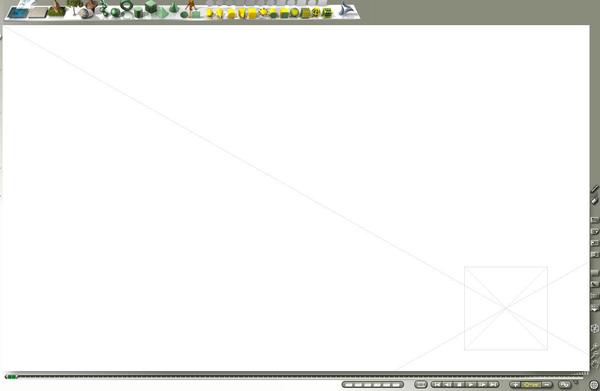

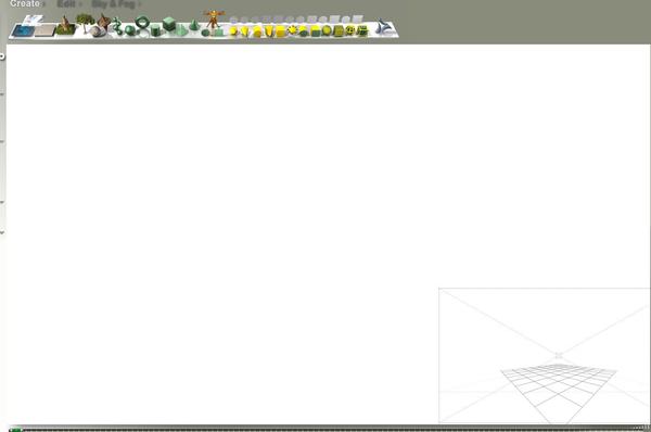

    This what I tried and the result I got. The grid result is rather faint but, the camera view ends up in the bottom left corner ad overall view unusable. When I use the magnifying glass on the left to shrink the view it distorts a lot.

    Nothing strange there. All this means is that you have a physical laptop screensize of about 1024 to 1440 pixels across, right?
    Unlike modern apps (meaning: any graphics app, 2D or 3D made after 2000), the Bryce document size window doesn't scale. You can scale your view WITHIN the document size you've set, but the window is the window: If you've set a window that has a greater number of pixels that your screen size can actually handle, You'll only see a portion of your document size, starting from the top left quadrant.
    And there's no document size scrolling :/
