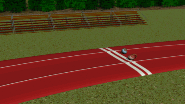

I have an animation with a ponytail attached to a ball character and when rendered over the network, the tail doesn't move or stays in the rest/initial position (except for maybe the frames rendered by the local system).

Attached is a animated gif of local machine render (where the tail moves) followed by the network render.
Yes, those are the only files. And no, that's certainly not right. I'll take a look... it used to work on 8.1, so that's disappointing.
It appears that Carrara no longer plays every frame at the rendernodes. Many effects depend on state that "came before" the current frame, and so the modifiers and behaviors need to be walked through from frame zero forward, even if the node is only rendering a later frame.
That means that none of the delay-related operations are going to work on a network render. I'm not sure how to fix this.
