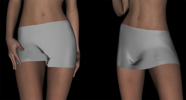

Hello!
I have created a very simple tight and short skirt for Genesis2Female. Done in Hexagon. Back in DAZ Studio I rigged it to G2F. All without problems. The skirt fits her well and follows all shaping morphs. Very nice.
But there is one big problem:
As soon as I bend her legs it looks awful. The skirt does not follow the bend as it should. Have a look at the pic to see what I mean.
Now, what can I do to avoid or cure this probelm?
Thanks for your suggestions!
800 x 432 - 59K
    You need to manually smooth the thigh groups on the X axis in particular but probably on all of them. It copied rigging directly from G2F, which has a gap there where the skirt has geometry.
    This is done with the Weight Group Brush: http://docs.daz3d.com/doku.php/public/software/dazstudio/4/userguide/creating_content/rigging/tutorials/weight_map_brush/start
    Just using the Smoothing instead of the Painting option. It's the second from left at the top of the Tool tab with this tool active.
    Another option is to create morphs that improve the fit when the leg is bent, also called JCMs. If you're interested I can go into that as well.

    Thanks for your answer!
    So, either Weight Brush or morphs. Hm, depends on what is easier to do and what looks better. I have already tried the Wight brush from the Tools menu, but nothing happened when I used it. Maybe I did something wrong. I have to take a deeper look into that. Would the morph solution look better, or is it easier to do? I already have some experience with morphing. I made a shape morph for G2F in Hegagon, just for fun and testing, and that was not hard to do.
    Omg, I just followed your link for the Wight Mapping explanation. That seems to be really complicated. So maybe you could be so kind and tell me more about the morph solution.
    Thank you!

    It's not simpler than the weight mapping.
  • XoechZXoechZ Posts: 1,102
    But maybe more fun :-) And better control of the "flow" because morphing is done in the modeler (Hexagon in my case) and I simply love modeling. Much more than fiddling with joints and bones and stuff in DAZ Studio :-)
    KK. Here's what you do. I normally create three main JCM on a shorter skirt: left thigh, right thigh, and both thighs.
    For the left thigh:
    Delete Genesis. Only your skirt should be in the scene.
    Bend the skirt's left thigh to 90 degrees.
    Export it as an obj.
    Import that obj into Hex and smooth it out. I have exported Genesis with the thighs bent separately and together for use with this.
    Export from Hex again with a name like "Bend L Thigh" or "Left Thigh Bend Helper."
    Select the skirt in DS and activate Morph Loader Pro. Navigate to your new morph to load it. Give the group a name like Morphs/JCM and turn reverse deformations ON before you click Accept.
    Now when you turn on that morph with the thigh bent, it should correct the bend.
    Turn it to 0, unbend the thigh, and repeat with just the right thigh bent and then with both thighs bent. You can turn on the morph to different degrees to help with different amounts of bending.
